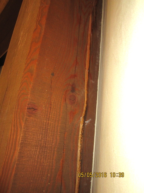

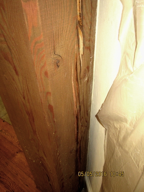

I've looked through the archives, but didn't find anything talking about checks this large. I'm looking at large doug fir timber columns and beams (12x14 or so), about 7 years old. Construction pics show that they were straight with no checks at all when installed, so they must have been wet when milled and installed. Now, one column has a 3/4" wide by about 5" deep check on one side and a corresponding 1/4" wide check on the other (directly opposite, but I can't tell if it goes fully through).
(upper part of col check)
(lower part of col check)
These checks seem larger than the "no big deal" variety, although the timber system is largely just decorative. I'm thinking of lag screws to pull the column together or at least stop further separation, if possible. Of course it's also a $3million house so it has to look acceptable aesthetically.

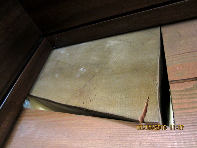

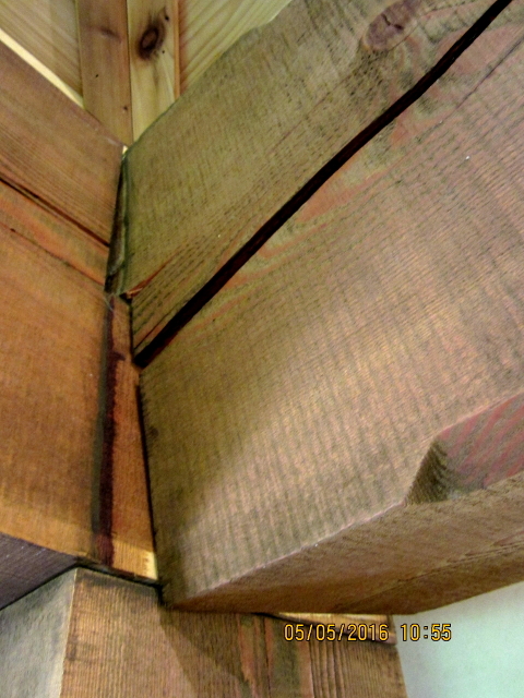

The beam above it has twisted so much that it is off its seat on the lower beam, and has cracked a portion of the beam off from pressure.
(side view of beam and top of column)
(backside view of end of beam, showing crack and rotation on beam seat)
I'm thinking of shimming it with hardwood to get the pressure off the cracked portion.
Does this sound reasonable? Any other ideas? And thanks!

There seem to be several funny things going on in your pictures. Is the column on the interior? It seems to show that there might be 2x laminations on the left face and about where the check occurs. The check actually approx. follows the glue line, but deviates because sometimes the glue line is stronger than the adjacent wood. I can’t point to an exact para. or sentence, but I think if you look at the grading rules, the codes and timber design texts you will find that they do recognize that that kind of checking can/does occur on large timber members and they account for some of that potential in their grading and allowable stress values. It has surprisingly little affect on the member strength as long as check is relatively parallel to the long axis (the grain) of the member. The exception is if the split/check slopes out to an outside face of the member, which has a weakening effect. In the column, that vert split is akin to a horiz. check or split in a beam, and there we know that as a potential horiz. shear problem.
The beam photos show a real horiz. shear crack, at a reentrant corner, in a high (large) notch in a beam which does appear to be a solid timber member. This member also shows some typical checking, just below the reentrant corner, and it also appears to be an exterior detail. Take a look in the NDS and a good wood design textbook about what they have to say about the problems with notching beams in high shear areas or on tension faces.
Generally, I think your idea of long lag screws (maybe through bolts), some clamps to assist in their installation, and some good waterproof glue in the cracks are about the right approach. Then, instructions to watch and see that this fix settles the problem down, and the cracks don’t grow any further. If the lags and a washer plate end up exposed, I’ve beat the plates a bit with a ball pein hammer, painted them flat black, and sold them as wrought iron hardware. You put a matching fake one on the other end to make it look right. Your idea of hardwood shims for the beam seat sounds about right, and you might put a couple long lags or through bolts up through the whole beam just to protect that reentrant notch corner.

The crack at the beam notch looks fairly new. I’d investigate a bit what caused, or what allowed that beam to roll/twist that way. The beam doesn’t appear to have any lateral support below the bearing notch level. And, if that is an exterior detail/corner, I’d try to do something to divert water from the above corner away from that nasty (messed up) detail of beams, notches and column end grain.

That shear crack in the 3rd pic is the same as the piece breaking off in the 4th pic. It's crushing it while the rest of the beam twists on itself.

I'd have to guess that a pretty large moment would be required to rotate the beam in the notch as shown. Can you find witness marks of something being jacked against or impacting the bottom of that beam?

The notched beam is a problem. In order of sexiness:
1) Jack the beam a little and sit it on a nice steel bracket mounted to the side of the column.
2) Reinforce the beam with some of those nifty new timber screws. These guys will even design it for you: Link.

Among woodies, there is a school of thought that, within reason, the development of checks within timber members serves to relieve internal stresses and thus actually strengthen the afflicted member. I worry that reinforcing/repairing the columns might actually have a negative impact on aesthetics. When you close up / secure the existing checks, the member may seek alternate avenues of relieving internal stresses. In that respect, I'd definitely prefer a gap filling strategy to a gap closing strategy.

I just had a nice chat with the guys at AITC - they were super helpful. I think I'm going to reseat the beam on some shims to stop the crushing and then put a couple (disguised) crack monitors on the beam seat and the column check, to see if movement continues.
