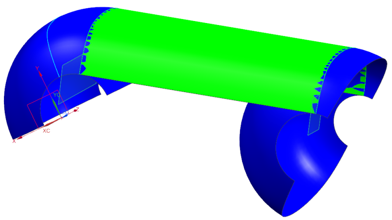

Hello,
I have problem with create surface tangent to two other faces.
Is it possible in NX create surface tangent to two faces (surfaces) without define curve onto the faces?
I found operation like Sweep-Section-linear but in this cases I can only choose one face. I want to choose two faces and for example spine curve. Catia has tool for create this tangent surface.
Green surface is a surface that I need create.
Regards
Marcin

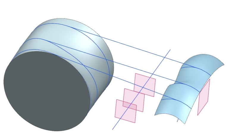

I attach prt file. I want to create tangent surface for two object. Surface must have straight section.
In this cases in order to have exact result I must create many sections. It’s bad solution if I have a long objects because I must create for example 50 line.
Do You have idea how to do it?
