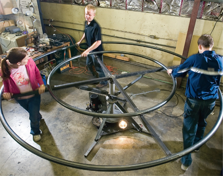

Shackle everyone to a big turnstyle and call it a new crossfit exercise.

BYU students design system to be powered by kids on the playground...

RE: Power generation from gym
"Shackle everyone to a big turnstyle...."
And 10 years later the lone survivor is RIPPED.
As around 2:30 in one of my most fondly remembered movie scenes.
https://www.youtube.com/watch?v=z5KYZ74OAak
