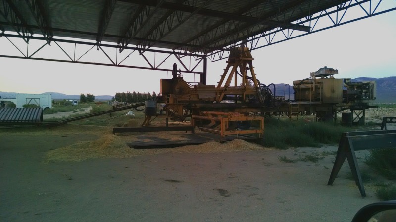

This valve is from the 70's. It takes 24 volts DC, and it opens one way. There are 2 valves on the Ram, one goes out, one goes in. Same plate on both. The electric part of it shorted down to .6 ohms, so it blows the fuse, therefore I disconnected it and have a human running it manually with the slide button on the bottom. I wrote the program for this machine using a PLC, and ended up the caretaker of this monster. Since I'm not into hydraulics at all, how does one go about finding a 45 year old replacement? I don't even know what the symbol on the plate means. My knowledge of this is simple, if you put 24 volts on the 2 wires, the ram goes out. 24 volts on the other one, it goes in. Both at same time? Never tried.

Thank you, doing that now. I'm not sure why they have 2 valves for this, where other things on this beast use 1 valve for both directions. This valve controls the flow which goes into another hydraulic -> hydraulic valve, so maybe that's why.
In the picture, this valve controls the flow in that 12' tall ram sticking above the building.... Bit off more than I can chew? Maybe.
Serial number on this machine is 00001. 100% custom one off build.

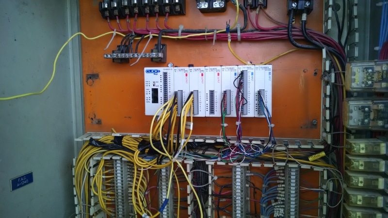

New controller I put in it. Click PLC. Thanks for the help, some guy in Utah called me back, he had the coil part in stock. Amazing... $28.00 + shipping.
