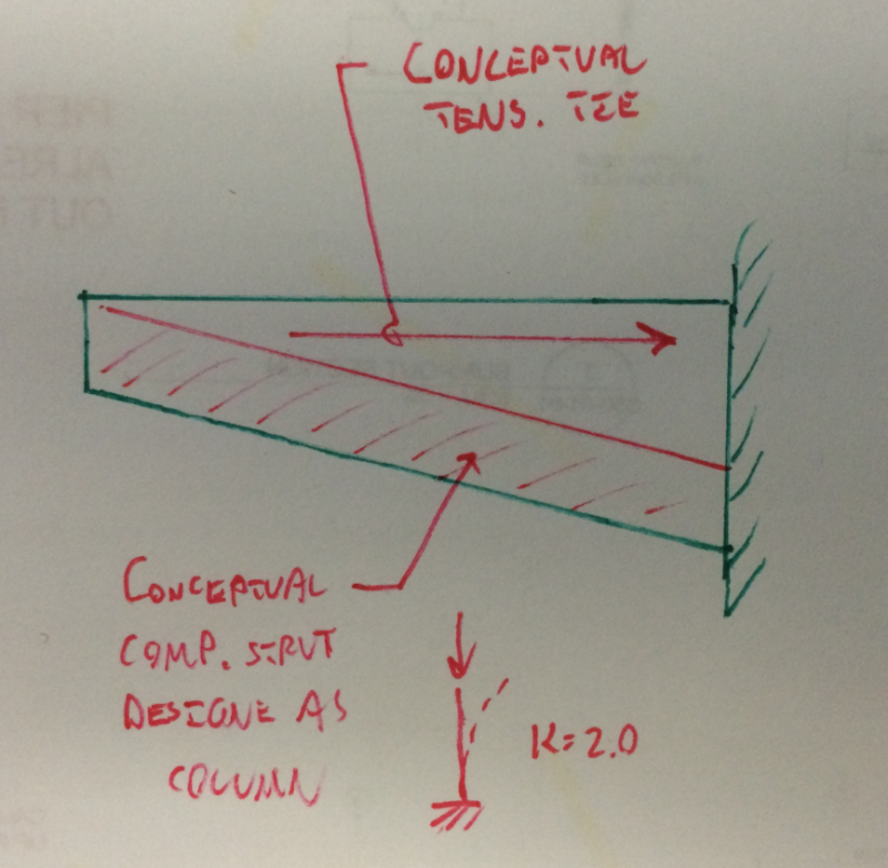

My knowledge of Aussie codes is sparse so I can't help you much there. However, I've had some success with the design model shown below. Basically, I treat the plate as a truss with tension and compression chords. The method is quick to apply, reasonably conservative in my opinion, and can deal with the non-prismatic nature of your section. You're capacity will be small but, then, I imagine that your demand is too.

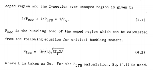

I may have to cut and run on you Jayrod (good call about the double length though). The clips below are from the 1984 source doc by Cheng and Yura. The ends of the coped sections are indeed restrained against rotation. However, they use twice the cope length in the buckling equation. In the end, we may be comparing two equivalent conditions here:
1) LTB simple span (2.0 x C) with the ends prevented from rotating.
2) LTB cantilever span (1.0 x C) with one end free and the other fixed against rotation and warping.
Regardless, I get the impression that the design method for a prismatic plate just comes down to the classic elastic LTB equation. How to handle the taper properly is an interesting wrinkle though. Base it on the deepest, shortest, or average section? That's one of the things that I like about the method that I pitched above. It actually deals with the taper explicitly.
The analogous tapered beam for LTB evaluation would be shallow at the ends, where faux rotational restraint is present, and deep in the middle where the restraint is essentially warping restraint due to symmetry.

I've done this by drawing out a triangular stress distribution to get the extreme compression fibre stress. Then I calculate buckling stress of a similar thickness column. Pretty similar to KootK's method.

I think I'll run with the truss analogy for now. I'm not too concerned with over designing (from a potentially slightly conservative analysis) considering the relatively insignificant increase in cost that may occur. I'd rather be comfortable knowing that it has actually been designed. It will only add to my knowledge to make more empirically (yet safe...) based design judgements in the future :)
