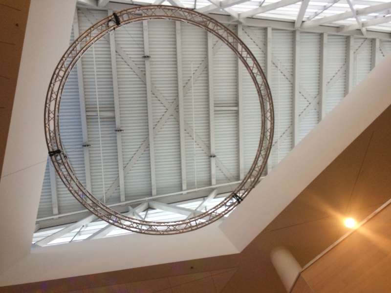

Is this corrugated metal deck over steel beam? What part of the world are you in? The photo below is an example that I encountered over the weekend.

Bracing is normally provided by the deck if it can act as a diaphragm. I only consider the use of roof bracing if the deck cannot function as an adequate diaphragm to carry loads over to vertical bracing or shear walls.

The cross bracing may or may not occur where you want to brace the rafters. Rafters are braced at the top flange by the purlin connections, and the normal way of bracing the bottom flange is with fly bracing (diagonal braces to the purlins).
