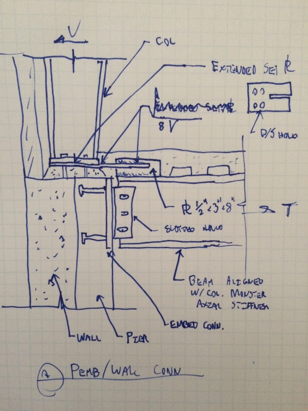

Got a client who wants to build a 2 story PEMB house over a basement. The basement will be concrete walls supporting bar joists and metal deck.
The outward frame thrust is about 13k - mainly due to gravity loads from a green roof on top. I was thinking about tying the opposing frame legs together with a 2 1/2" piece of tube steel running in the floor system cavity rather than trying to resolve the forces individually into the basement wall. Of course the net horizontal force will still have to be dealt with.
The PEMB folks seem to be on board.
Any things I should consider?

Balanced thrust aside, I still like the idea of connecting directly to the floor deck framing for unbalanced column lateral reactions rather than taking them out through the basement walls / retained soil.

Nice detail, (how do you have time to do this :>) but I feel mine is far simpler (don't have time to draw it right now.)
Less fab work. Just cut it and weld it. It could lap over the intermediate beams so length isn't even critical.
The tube steel tie would take the opposing thrust. The unbalanced loads (i assume you mean the net lateral) would go into the piers, into the wall , into the joists and into the diaphragm without using the retained soil. The net lateral is significantly less than the spreading thrust so this is not an issue.
