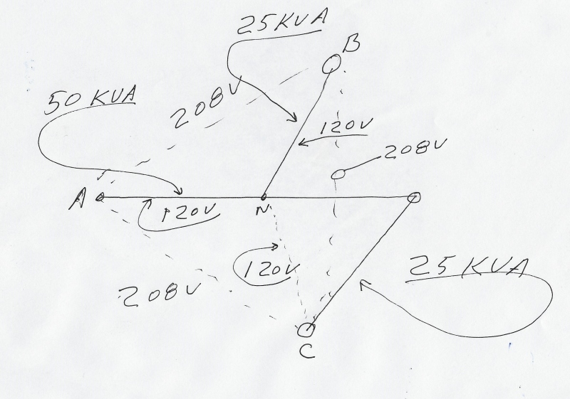

CR, while we are travelling down memory lane, Have you ever encountered a connection I heard called a "Winnipeg" connection?
This is a connection that uses two phases and the neutral, similar to an open delta connection to develop three phases from two phases and a neutral, BUT the output is 120:208 Volts.
