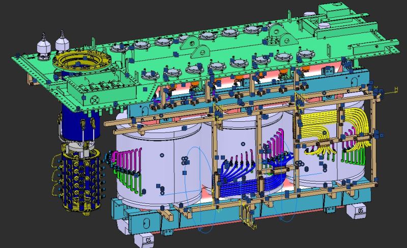

In principle , I have some splines that represent electrical conductors (no harness license here, just GSD). Finally, there should be some kind of length measured so the worker in the factory knows how to cut those wires. By trial and error over the years, we managed to translate this in a formula, the spline measured in Catia plus 15%, and rounded upwards to 50mm.
You can find below a picture
The blue and the yellow wires are separate parts, each containing just a spline. The goal is to retrieve this length information in the drawing BOM, so when I modify the model or modify the path of the conductor, this also reflects in the BOM.

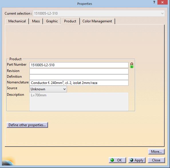

This works ok doing it manually with every spline part, just masuring the spline with "measure item", and then going to formula editor and entering the formula by hand.
I want to automate this and just open the spline part in a separate window and run a macro that measures the spline, applies the formula, and puts this information in the "product description" field, like in the image below:
I would appeciate the help.

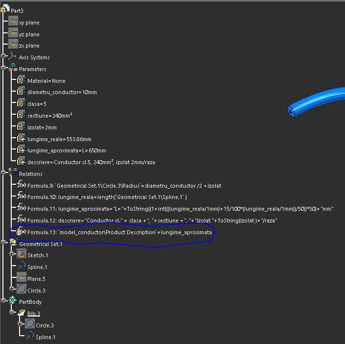

Sooooo, after some half a day fiddling with "powa copy", I managed to get the job done let's say 90%.
For the remaining 10% i need the help of you guys.
You can find attached the original power copy file with all the stuff needed.To make it work you just need a spline and a point.
The hard part is still self referral.
I am trying to fill in the Product Description field with "lungime_aproximata" parameter.
This works perfect in the original (model_conductor) part, but when I try to instance the power copy, everything is ok, except for formula 13.This is happening because "model_conductor" is still in the formula, a thing which now doesn't exist.
How do I get over this, so the formula retrieves the correct part name (the current part name), like this:
Formula.13:'part_xxx\Product Description'=lungime_aproximata
and not like this
Formula.13:'model_conductor\Product Description'=lungime_aproximata
Any help appreciated.
