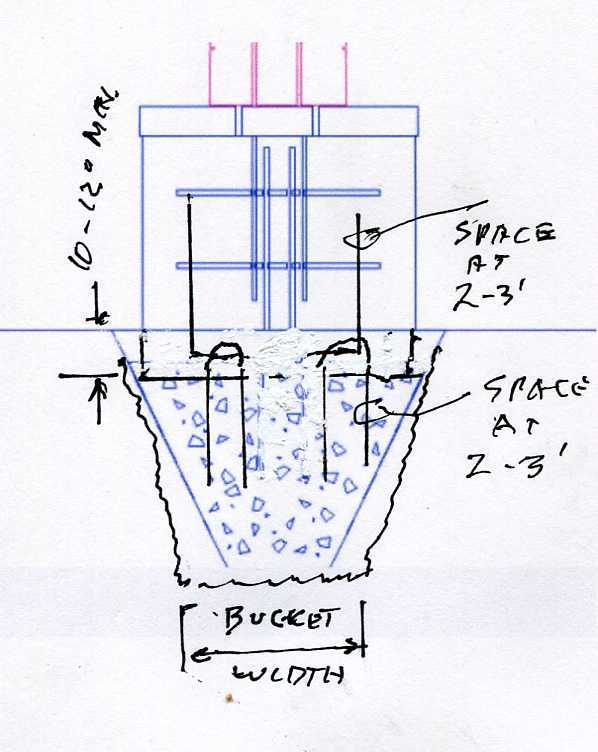

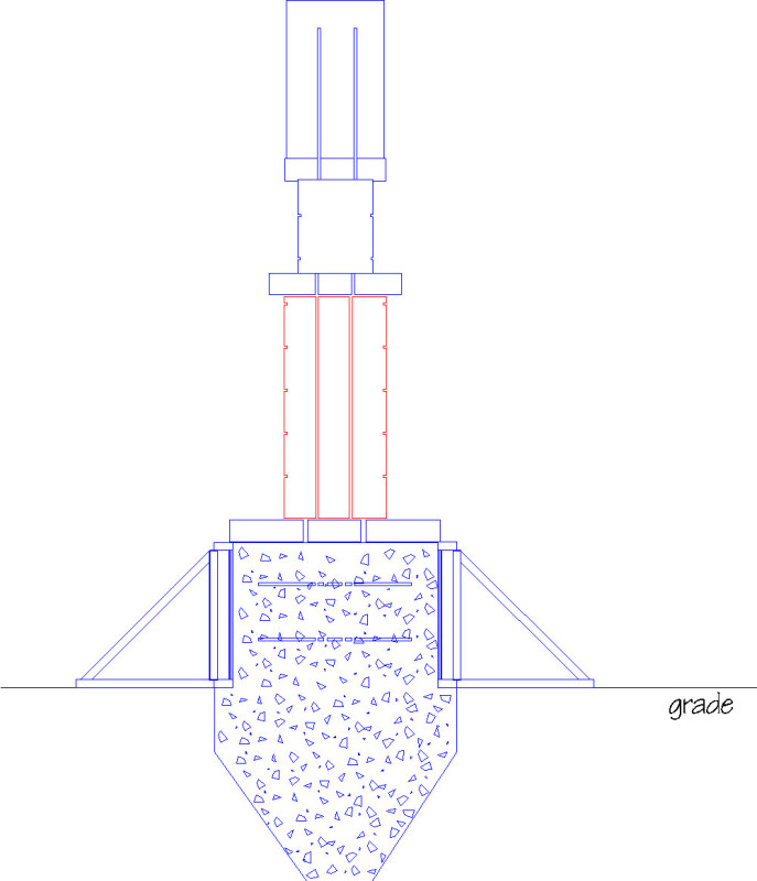

On a monument sign I'm going to build, I just calculated the weight of 8 yards concrete, 300' of #4 rebar, 93- 12x8x16 block, 24- 8x8x16 block, concrete in the block cavities containing vertical rebar, stone-veneer facing, mortar, EIFS caps, and two sandblasted and CNC machined high-density urethane sign units. I ended up with 43,755lbs. My permit has already been issued, but since I had forgotten to calculate weight and they never asked, I am concerned about the size of the footer, its pressure on the soil, and wonder if I should "overbuild".
The footer I have in the submitted drawing would be 3'2''x 17''which gives it a footprint of only 53.833> sqft. That comes to a direct vertical pressure of 812.78 lbs/sqft and it is in clay soil. Both the county planning departmenand the building inspector have already approved as is but if I widen that footer by just a foot on each side making it 5'2''x17' (99.875 sqft), that will distribute the weight more, lowering the pressure to 438.1 lbs/sqft. and may help me sleep better knowing this ginormous sign won't sink after a few heavy rains. Do you think this is necessary? Thanks! Note* This is NOT for a client. It is my own sign, on my own property, and I will notify the building department before doing this. Thanks for your advice. Wayne

There is no frost depth as I am in Florida. The footing in the plans is to be 12" deep with a "stabilizer" going down to 36". I have raised the 'pedestal' above grade and added the alternative footer, which is almost 86% wider, to the right side of the drawing below.
RE: Soil Bearing Capacity
Looking at your details and wondering about building the foundation, I wonder if you have thought of the complications a contractor will go through to do all the fancy underground details. No one will see it. Wouldn't a big ugly concrete block, no fancy sides, etc. with minimal reinforcing down 3 feet with more concrete be cheaper and less time consuming to build? Also less likely to tilt.
Not sure. It already going to weigh 43,755 lbs. The angled sides under the ground help distribute the weight with less concrete, but making them straight with the same footprint is going to add another 2,550 lbs to the thing. I will dig the footer with a small backhoe, but a square-point shovel will carve out those angles in less than an hour. I don't know, just trying to cut down on weight and distribute the weight because the thing is already very heavy and this soil gets wet and soggy sometimes.

Ah...pet peeve..."footer"! If you're an engineer, don't use it!
Agree with Oldestguy and SlideRuleEra.....your detail is a lot more complex than it needs to be. Your sign is a simple monument sign.
You're in Florida. If my research/guess is correct, you are in the Tampa area. You mention that the soil is clay. Are you sure it is clay? That would be unusual to find true clay at the surface in that area, though there are some clay areas/pockets to the northeast of the Tampa area. It might be clayey sand. In any case, your bearing pressures are fairly low, particularly your wider detail. Unless you have some really crappy soil conditions, most anywhere in Florida you can get an allowable bearing pressure of 1500 to 2000 psf. Look at the buildings around where the sign will go. Is there anything extraordinary about the way they are built? Most likely they are on simple shallow foundations and performing well. There are plenty of good geotechnical engineers around there who could give you an off-the-cuff synopsis.
I've designed several similar monument sign foundations. Mine are simple, cast-in-place concrete blocks with minimal reinforcement just as OG described. Most of the time, for these signs, we need ballast for overturning moreso than other reasons!

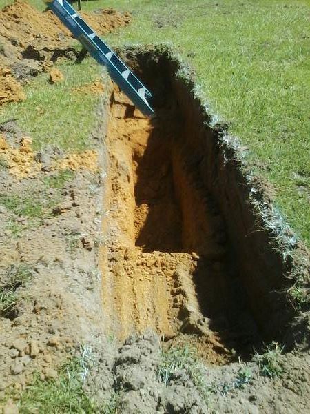

Here is what I'd do. I'd have a back-hoe there and excavate a hole measuring about 4 ft. by a little over 17 feet, with SLOPING SIDES. Bottom width could be bucket width. It does not have to be straight sided. Three feet depth is plenty and less probably would be OK also. Make sure the sides don't have any significant loose stuff. No forms needed. Immediately fill with 5 bag (cement) mix concrete of stiff category (not soupy) to about a foot below final grade, level top. No re-bars within it, but very soon there after, as soon as you can, shove "U" shaped re-bars at least 18" down into it. leaving 8" of upside-down "U" exposed in the area where a formed thick slab footing will later be placed. Then with new forms in place, you can get going with reinforcing projecting up as needed for reinforcing your wall blocks, with bottom to be within the new footings with right angle bends on the bottom ends for anchorage. Your 3 ft. wide footing probably is OK. The stiffer you can keep the concrete the stronger it is. Once setting is well underway, keep the footing moist.
Concrete is interesting stuff. If you make it too soupy, the resulting strength is lower than if it is stiff. However, then once setting starts, you don't let it dry out because it needs water to develop the "glue" that holds things together. Given a continuous moisture environment concrete will continue to gain strength at a reduced rate for years. However, 30 days of moist conditions is plenty and even a week is OK in some circumstances.
I'll add that for the purpose of holding the monument sign, settlement should not be of concern, since it won't be noticed. However, local information indicated no problem there anyhow.

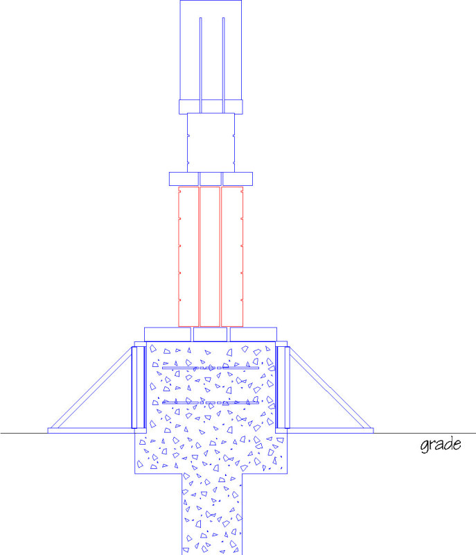

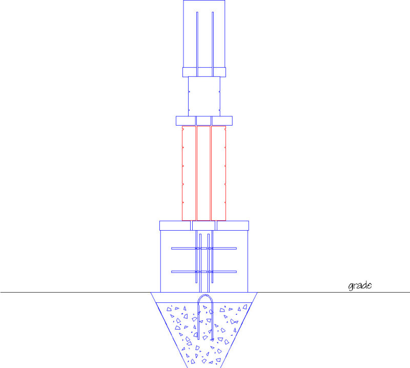

.........I'd have a back-hoe there and excavate a hole measuring about 4 ft. by a little over 17 feet, with SLOPING SIDES. Bottom width could be bucket width........[/]
Is this what you mean oldestguy?
This is a rough idea. You need some depth for resistance to leaning and your 3 feet seems OK. The re-bars are mainly to make use of the deeper footing for resisting that overturning. I figure a back-how wold dig this like a trench and getting exact smooth sides is easier that way, I think. If you can, ask the digger to place (tack weld or better) a steel plate to cover the teeth, leaving smother base, etc.
The FORMED footing on top can be something like you had originally planned (apparently some grade raising there). It needs to be thick enough for tension transfer from "hair pins" to the vertical bars. I didn't show other vertical bars that you will need to go up into your higher sigh places. Ideally they need to get resistance from the upper formed footing one way or the other, perhaps by lapping bars as much as you can.
Wayne...it is not necessary to slope the sides. In fact, if the clay swells from water, it would be easier for it to push the sign up.

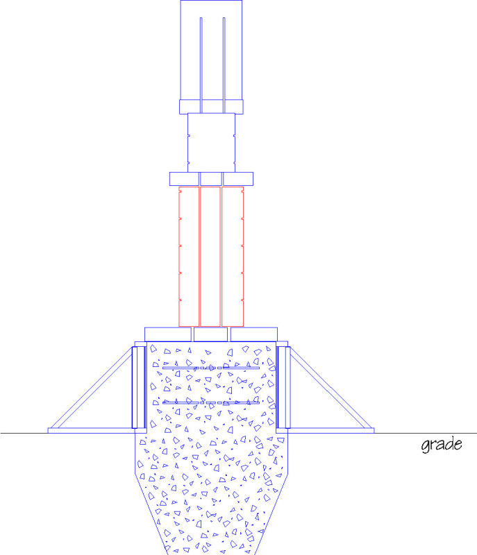

Only slightly sloped?
I wouldn't slope the sides at all. Make them vertical. You don't save that much concrete and you complicate the construction. It also reduces your overturning resistance.
Ok, this is basically what I had from the beginning. I wanted a "stabilizer" jutting down further into the ground because we are in a 130 mph wind zone. But after calculating the weight of this thing, I wonder if hurricane windsor gusts would impact this thing at all? Maybe a direct hit from a tornado would.

Guess I stirred things some. Side slope can be anything that stands. If vertical stands and doesn't cave, fine. Just don't leave significant caving there when placing concrete.
I'd not ask a contractor to do the last figure narrowed "fin" without a heck of a lot of work.
That higher formed block may be more trouble than a short "footings" . Holding that higher form there won't be easy. Once it starts to move you really gotta move also.
If this stays rather complicated, the only way I'd do it (if I was a contractor) would be cost plus.

I'm a tad late to the latest - but I too do not see why the below ground excavation is wanted to be angled . . . a straight sided excavation would be more reasonable. Tomlinson has a good discussion of "trench footing" .. . hoping he is okay with it - see attached.
Quote (Tomlinson)
Uplift of these foundations causing hogging of the superstructure can result from adhesion of the clay to the sides of the deep strip, particularly where the excavator has produced a trench wider at the top than at the bottom.
I see what you mean. Thanks Big H. Straight sides they will be. I plan to pick up the blocks and form material this afternoon. The block will be stored inside until ready to use and I'll go ahead and make my forms. Then I plan to rent an excavator on Friday and hopefully we can get a concrete truck out here by Tuesday. Thanks!

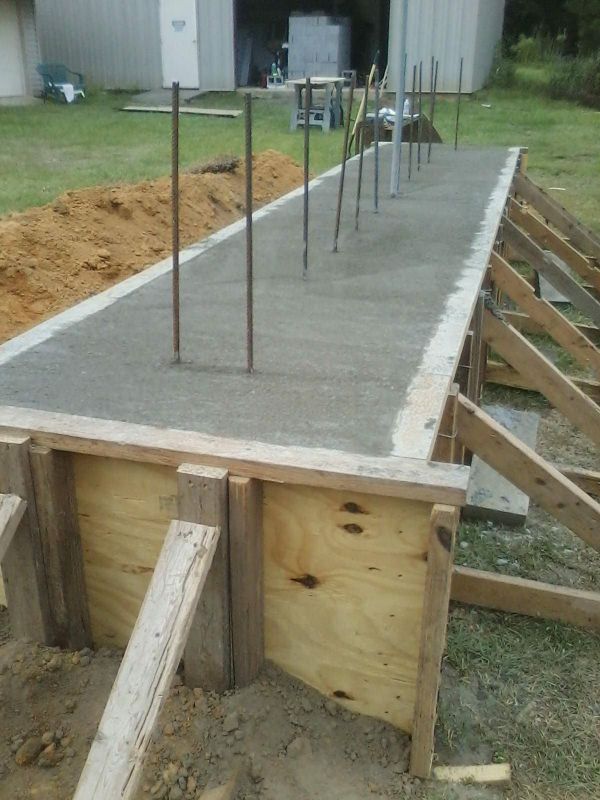

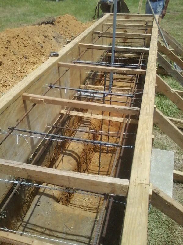

We made a trip to Marianna, yesterday evening, and picked up the block, rebar, and some of the form materials, The blocks will be stored inside the shop to keep them dry until time to lay them. This is to help prevent the mortar joints from cracking later because concrete blocks expand slightly when wet (according to what I have read). An 18' x 4' area is staked out at left of the photo.
https://www.bing.com/images/search?view=detailv2&a...
I used 9 gauge galvanized fence brace wire, strung it between opposite studs on the forms top and bottom, then twisted the wires tight and placed a small rod in the twist-holes to keep them from unravelling when the pressure was applied. As you can see I also staked the thing from about 3' out and installed diagonal braces. My forms did not move or lift at all. :)
I will be keeping the concrete wet for a couple of weeks to make sure it's cured before going to the next phase. Thanks for the help y'all.
