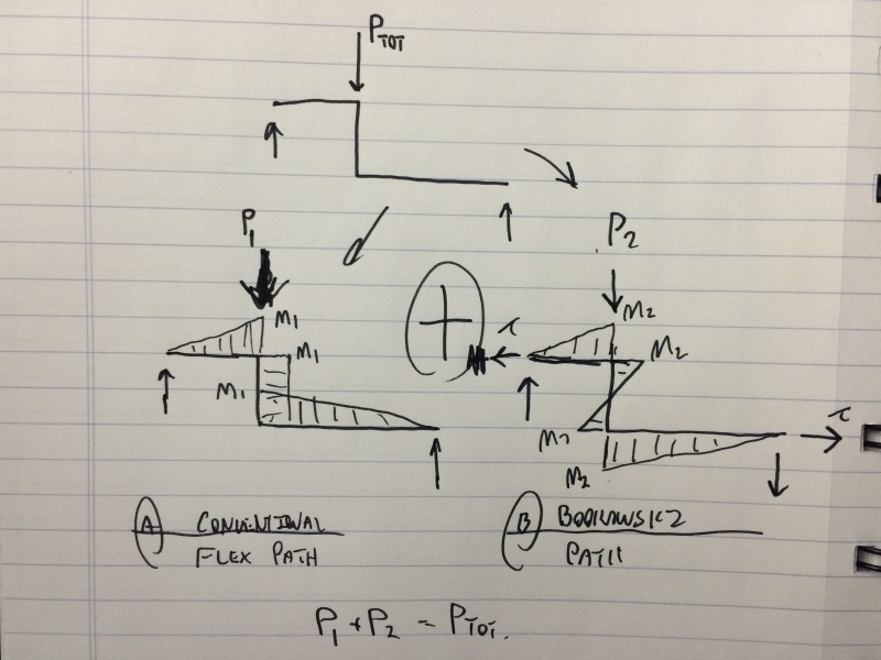

Hi all
Me and a couple of engineering friends were arguing about the deflection
of a slab with a step in it compared to one without a step. (See attached sketch).
My gut feeling is that it will create extra stiffness and reduce the deflection if
it has a step. I will however never take this into consideration if I designed such a
slab.
What are your thoughts?

Absolutely it does. With restraint, you get those membrane forces that I mentioned above. Membrane forces presenting as axial slab loads beyond the step would present as shear and flexure -- perhaps self limiting -- across the step. I've really been sticking to the small deformation assumptions that we normally apply in slab design.
Quote (bookowski)
So expanding on the op what is the best detailing here, are you detailing the step portion like a beam with closed ties and your slab bars like a corner joint?
I've got a great wishy-washy answer prepared for you. I expect that you'll find it wholly unsatisfying.
1) Regardless of the detailing employed, which may involve closed ties, my intent is always to create opening and closing corner joints. There's really no such thing as torsion in the step in the general "slab fold" case. Just flexure and shear transfer. If I go closed ties, I'll try to go with lapped U-bars for constructability.
2) The typical details used by my firm, and many others it seems, have some technical detailing deficiencies in my opinion. It's usually a combination of Z-bars with several of the hooks facing the mechanically disadvantageous way.
3) Often, I'm creating a detail that's meant to deal with both sagging and hogging moments. That muddies the detailing waters a bit at often is what gets me back to something that looks like closed ties / torsion even thought that's not my real intent.

RE: Deflection of Slab with step
Sketch quality ebbs and flows as you're about to see.
I messed around with some models over the weekend and came up
with some qualitative conclusions that I find pretty interesting. I wanted to make a comprehensive spreadsheet to study individual parameters in more detail but, as it turns out, that's hard. Here's what I've got:
1) A first order elastic analysis with lateral restraint at the supports will indeed yield two mechanisms of load resistance, one of which will involve axial load in the slab and shear across the step (henceforth known as the Bookowski effect). See the crude sketch below.
2) with the step at midspan, the Bookowski effect yields upper and lower slab moments that sort of oppose one another and produce no net vertical displacement at midspan.
3) we've been contemplating a step shifted towards the higher slab which produces tension reaction on the slab. If you shift the step towards the low slab (right of centre here), I think that you actually get compression reactions acting on the slab. This surprised me. In both cases, the lateral reactions on the slab produce an upwards deflection at midspan that will oppose the displacement induced by the imposed load.
4) in cases where the slab height is small in proportion to the span, I expect that the Bookowsi effect would be small. With deep steps, it seems to have a pronounced effect on bending moments.
5) since the two load paths share in resisting the applied loads, I believe that it would remain safe, in all cases, to reinforce stepped slabs ignoring the Bookowski effect and designing to the conventional moment diagram proposed at the top of this thread. In this respect, a shear failure across the step may actually serve to hasten the redistribution of moments to match the conventional load path. That said, I'm now considering using at least minimum shear reinforcement across my deeper steps to keep any shear cracks reasonably small.
Item number five involves quite a bit of judgement/conjecture on my part. I welcome any debate and/or dissenting opinions.
