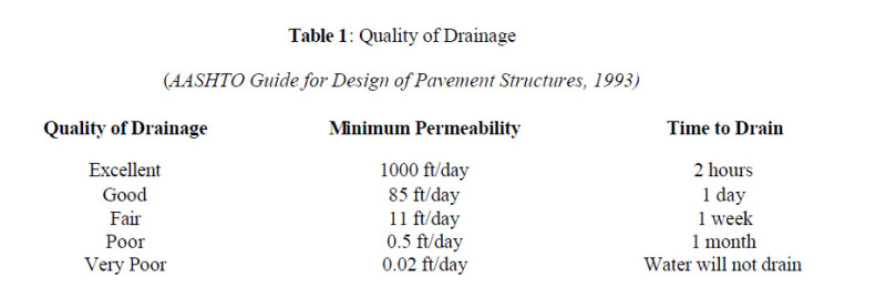

How do you recognize the quality of drainage shown in tables 1 and 2? There are five classes there, so assuming that normally base and sub base courses are composed of granular materials, how can I differentiate the quality of drainage? Does it depend on the percentage of fines?
RE: High water table
Okiryu...the "quality of drainage" is defined in the AASHTO Pavement Design Guide in the following table:
