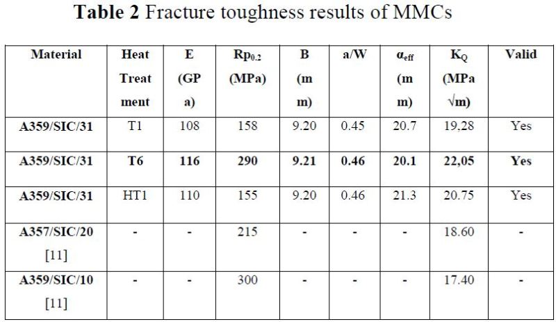

Hi every body
Is there any body knows the what is the Aluminum 359, "Transition Temperature" and "Gf(Fracture Energy).
I want to use the last parameter for "Damage evolution" in "ABAQUS" software.
I will be appreciated, If anyone knows how can i get this parameters.
With Best Regards.

Thanks metengr for your respond.
But in this paper there is property of Aluminum 359 with percentage of SiC reinforcement particles.
From the other hand, It raise a question, That is:
Can we get the KIC Aluminum 359 from this table of that Paper ?
I say when Al359T6+30SiC have K=22.05 and Al359+10SiC have K=17.40, Now can we say Al359 have K=15.18 ?
With Best Regards.
