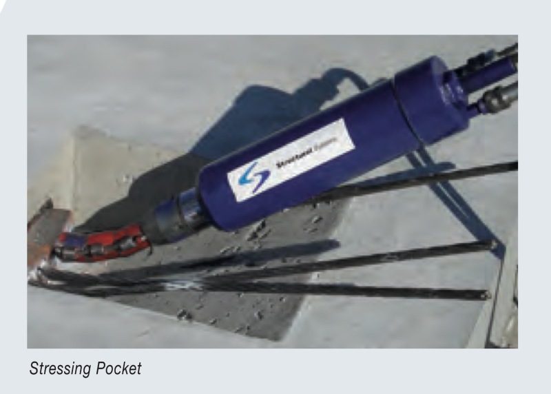

For UNbonded monostrand tendons it is a consideration, but for bonded tendons (and the OP is in a bonded PT market) it is lesser so, as for multi-pour placement the bonded tendons are cut (on site) to match the length of each separate pour and coupled using coupler anchorages and compressions swages at each construction joint.
Also, for bonded tendons, a single (or twin ram) center-hole jack is usually used, whilst for UNbonded a open-throat (saddle) jack must be used to access the intermediate pour tendons without 'threading' the jack over the remaining length of unplaced strand.
Photo of typical ram/jack used for bonded slab-system stressing:
