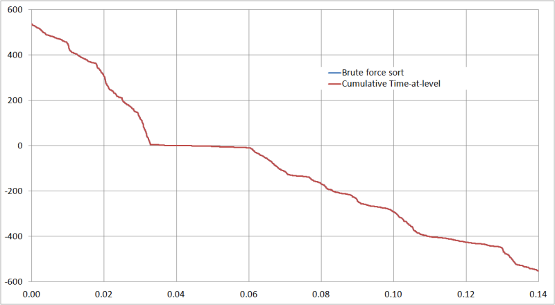

I have uploaded an example of the data I have and the kind of time-at-level curves produced from META. From the Excel file you can see that I have 1400 points from the raw data.
Please be informed that, it can be seen that the continuous time-at-level only has 101 points and the curve stop at 0s. This is due to the definition and construction method used as described in the link. In contrast, cumulative time-at-level has exactly the same amount of data points with the raw data, because it is just a sorting of data.
Thus it can be immediately seen that constructing the cumulative time-at-level in Excel is really not a problem because it is just a sorting.
The challenge comes in constructing the continuous time-at-level curve because it involves linear interpolation of more than 1 points of X for a single value of Y.

Yes you are right that the cumulative time-at-level curve is just surprisingly simple (according to the definition). If you re-read the link I gave in the 1st post then under the description of time-at-level, it provides construction description of the continuous and cumulative time-at-level curve, in that the cumulative curve is indeed just a sorting. I too have no problem making this curve myself in Excel.
The real challenge is at the continuous time-at-level.

RE: How to make time-at-level curve in Excel? (for dummy injury evaluation)
one) Create a suitably dense array and then, for each interval on the continuous curve, evaluate which elements of the grid that segment crosses - essentially a vector to bitmap conversion.
When they are all converted, just start at the left end of each row and begin reading the array until you hit a filled in element. Start counting elements until you hit the next one - store that value. Continue reading the array until you hit the next filled in element. Start counting until you hit the next one - if the value is larger, replace the previous value, otherwise keep going.
If a bitmap is created there are a number of image processing tools to return the counts. This is basically how Run Length Compression starts.
At the end, for each row in the array, you will have a number that corresponds to the largest continuous section. That's the entry in the time-at-level curve for that threshold value.
The paper suggests 100 vertical divisions, but it might be valuable to use 1000 divisions and downsample at the end with a linear interpolation and averaging.
two) To do this by direct interpolation means, for each threshold, then for each segment, check to see if each segment crosses each threshold and, if it does, interpolate the related time it crossed, creating a list of times. Then going through the list looking for the pairs with the greatest differences.
On the spreadsheet it would have 101 columns, one for each threshold, and in each, the interpolated time for each segment. Segment 1 is from row 1 to row 2; up to segment N which is from row M-1 to row M, for M rows of data.
I would recommend creating a VBA function that takes the two times and two thresholds and the target threshold and returns either 0 or the interpolated time.
For each column, create several other columns. One will reflect the previous time entry until there is a change, and will then have the new time -> If C was the interpolated "time" column and had a series of zeros (segment did not cross) then a number, than more zeros, then another number, etc. The first cell in D would be =C1, and D2 would be =if(D1<C2, C2, D1) The result would be that every time Cx was a greater time than the last time, this would be repeated until the next non-zero time.
The E column would have the formula =D2-D1 in E2+. This would give the interval lengths.
The next column is the trickiest - only the odd changes are desirable. That is, for any given interval, starting from the left, each time one crosses the curve, count up one. The first crossing, when going under the curve, the count is 1, an odd number. When leaving, it becomes 2, an even number. So it needs to have a counter that increments whenever there is a time delta in D. So, E1 => =0; E2+ =IF(D2<>0, =E1+1, E1)
The next column is just a test to see if the previous one was even or odd. There's an Excel function for that.
The last column is the truth of an odd times the value of time, so any values that represent time under the curve are kept and the remainder are discarded. Something like if(odd-entry = TRUE, time_interval, 0)
Look for the max values in each of the last column and it's done.
To make charting easier, after the array of evaluations is made, cut and paste the row of maximums to a new worksheet and remove the unused columns.
