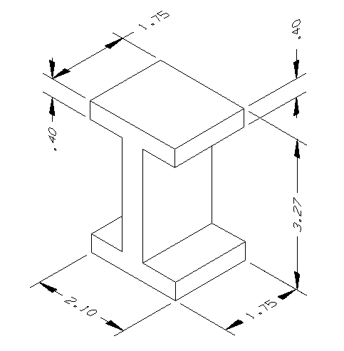

Dear All,
I'd like make a dialog with a picture demonstrating dimensions of the reusable part. If making this picture in 2D drafting, I can override the dimension text to a meaningful one as below. But if in 3D view by PMI dimension, I can't do the same thing, and I haven't found where to override the PMI dimension text.
Any advise or workaround?

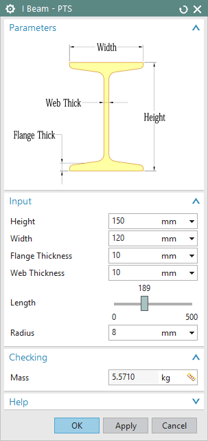

The dialog box most likely uses a raster image; generate the basic image where you like (drafting, modeling, etc), then edit it to your liking with a graphic design program (photoshop, gimp, windows paint, etc).
