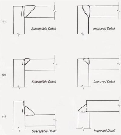

My take:
1) All three details are poor as they wold result in lamellar tearing potential. Bevel the horizontal plate instead.

Thanks Ed. Looking at the OP's details, I've noticed that they're showing a gap between plates. If that's intentional and accurate, that may obviate the concern for lamellar tearing as shrinkage would no longer be restrained.

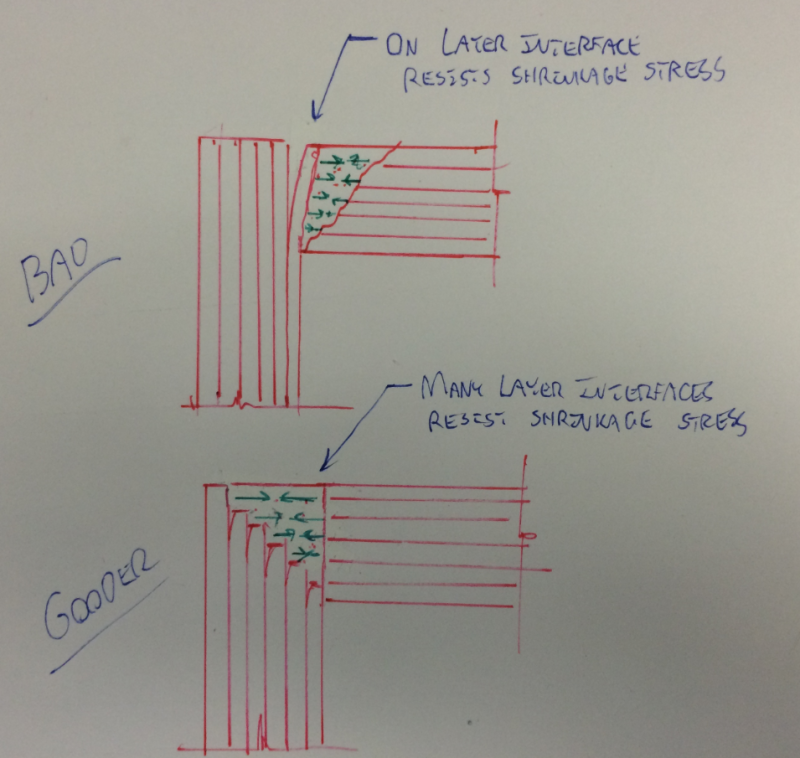

I like thinking. And it's a fine question that you've asked (#1). The reality is that, even with the improved detailing, there is still some tendency toward lamellar tearing. That tendency is just spread out over multiple lamina and therefor a good deal less severe. Let me know if the sketch below doesn't clear up #1.

KootK,
Thank you for the sketch!

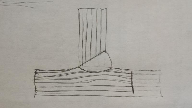

My understanding why option 2 is maybe better for full pen (I do not consider other types of weld as the full pen is what is required in my case): the stress in the weld area is spreading in the metall around. Bigger the area - less stress consentration in the joint. In option 2 overhang helps to spread the stress. Is what you ment metengr?
I have skethed out my understanding what will happen in the regards to laminating in the option 2. (Sorry for poor qualiy of the sketch) I think it is less affected in the case of overhang. I would like to know your opinion.

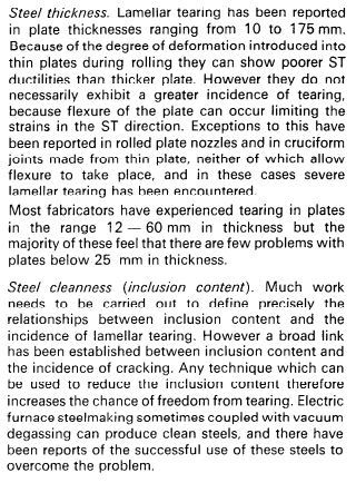

KootK's sketch and illustrations show the lamellar tearing issue well. I would point out, however, that lamellar tearing is generally an issue only in thicker plates. I suppose it is possible, but lamellar tearing in 10 mm thick plates is not on my radar.

hokie66,
KootK's sketch explains his point wery well but does not show what will happen to the plate number 2 (option 2 with overhang) on my sketch. Combining what said by KootK and metengr, I sketched out my understanding and I would like to know whether it is correct or not.

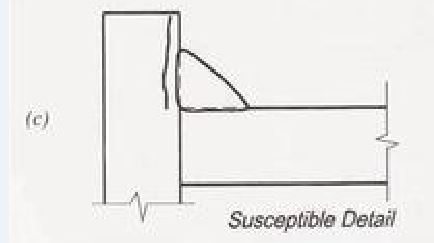

On the issue of lamellar tearing:
1) This document (Link) is quite comprehensive and appears to be the source document for metengr's link above. I've included a snippet below which speaks to the 1970's line of thinking on plate thickness and steel cleanliness.
2) Here's a more modern discussion (Link). The Grand Coulee example is one of the rare instances of a 10mm plate lamellar tearing failure. It is also an example of exceptionally high level of restraint. As I understand it, thin plates perform better with respect to lamellar tearing because their flexibility can take up some of the induced strain in many cases. I'm not sure how that would apply to the case at hand.

From a lamellar tearing perspective, I would agree that your #2 would be better than my "bad" detail above. As you say, you would be spreading the tendency for delamination over a larger area. That said, you'd still only be delivering the load to a small number of laminations so I would not expect it to be anywhere as good as my "good detail". Interestingly, the link that I supplied above includes something similar to your #2 in the "bad" category. See the clip below.
With regard to stress concentrations, I suspect the issues are less with lamellar tearing and more to do with stress concentrators that generally accompany a difficult to accomplish weld. You know, starts and stops and surfaces that are difficult to keep smooth and regular. The detail that I recommended, in a architectural context, would often be ground smooth which tends to ameliorate some of that. If this is a field weld, there is no doubt that the overhang, particularly when combined with two sided fillet welding, would produce a welder friendly, higher quality weld.
