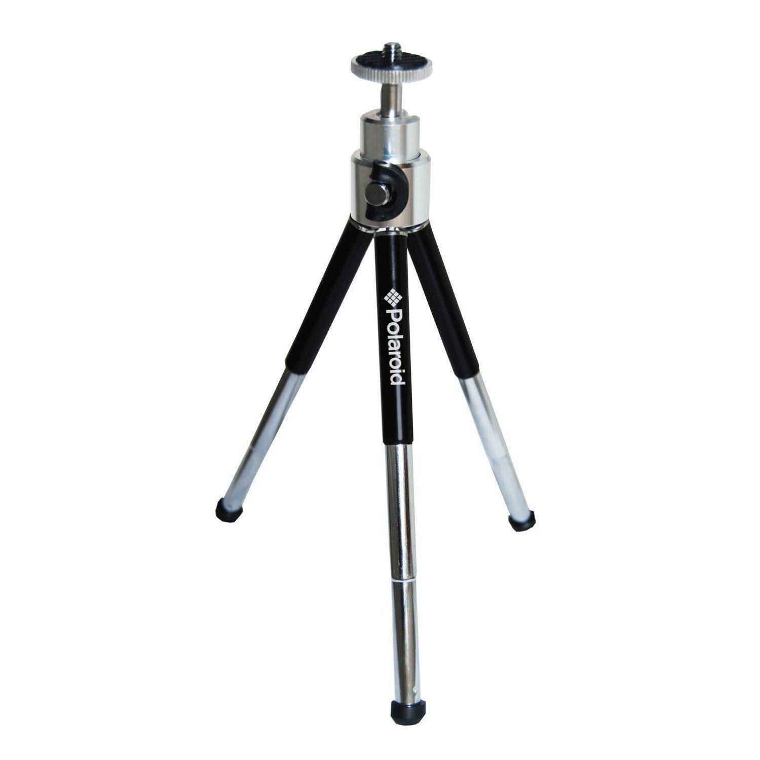

Are the feet just bearing on the foundation?
What is value of the estimated maximum transverse force at the top of the tripod (Rax?).
How Are the tripod legs oriented in the top/plan view?
120 degrees?
http://g-ecx.images-amazon.com/images/G/01/aplusau...
or inline?
Regardless, if the interfaces to the "ground" and I-beam are not very secure, and slip free, A few ties lower on the legs might provide some nice redundancy.

The legs are bearing on the foundation, equally spaced at 120 degrees. The thing that confuses me is that since this is more of a rigid frame, and not a pinned structure, wouldn't there be a moment reaction at the fixed connection to the tube in addition to shear? I believe Rax would be about 5547, because the compression in each leg is 36,000 = 3R_legSin(65), where R_leg = 13,240 lbs. Then you can solve for Rax using Pythagorean theorem. Also the reason for the 1/8 weld is the tube wall is .120. Is 3/16 possible with that thin of a wall?
