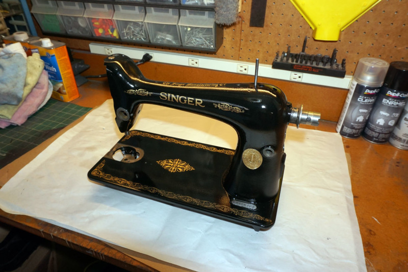

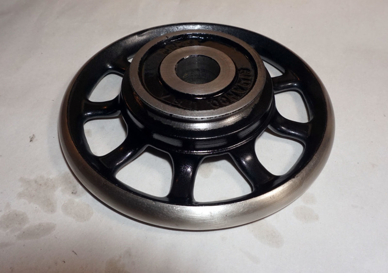

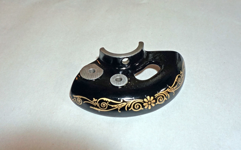

A status report:
Well I've de-greased and cleaned all of the internal parts and have them all packed away in Ziploc bags.
As for the head, I've stripped-off all the paint, sanded the bare metal and finally rinsed and de-greased it as well.
As you can see, the casting of the body is rather rough and on the back side there's some significant porosity so I'll need to either apply and sand several coats of paint or find some sort of primer/base that will fill and smooth out the rough areas.
Note that the decals arrived today and they're a prefect match to what was on the machine originally.

Looking good. You have a couple of options for the rough surface. There are high solids sandable primers. You probably can find these at a Napa auto parts store . There is also good old bondo. A good source of auto finishing supplies is Eastwood www.eastwood.com Don't waste your time with products like Lab Metal or spot putty.

John, use a thin body filler for smoothing the casting. You could use a high solids primer but that will take a few passes.
RE: Just started my first serious post-retirement project: Restoring an antique Singer sewing machine...
I stopped at my local auto-parts store today and picked-up a can of sandable primer and will give it a shot. I'll let you all know how it works out.

I was going to suggest cellulose primer in particular, as it is dead easy to use and gives a lovely finish. Have you decided on a painting process yet?

Another status report...
I've finished painting the head as well as a couple of other parts that needed to be refinished (the cabinet and treadle mechanism will come later). Shown below is a belt-guard which is part of the bobbin-winder and the hand-wheel. For these I just cleaned them up, sanded the rough spots and applied two-coats of Black Dupli-Color Acrylic Enamel. For the belt-guard I then applied the new decal and then two-coats of Dupli-Color Acrylic Enamel 'Clearcoat'. For the hand-wheel, after painting it I removed the masking from outer part of the hand-wheel before applying the 'Clearcoat'.
As for the head, I first applied two coats of Dupli-Color Sandable Automotive Primer, fully sanding both coats, then a single coat with a very light sand. Then two good coats of Black Dupli-Color Acrylic Enamel. Then I applied all the decals and after they had set and dried, I applied two coats of 'Clearcoat'.
The hardest, or at least the most tedious, task so far was masking/plugging all of the threaded holes, oil holes, slide-ways and other opening in the head. This included the bottom which I also gave two coats of paint and a coat of 'clearcoat', but no primer as I didn't take the bottom-side down to raw metal as the shapes are just way too complicated.
Well now I'll set the head aside for a few days to let the paint fully harden before I start to reassembly the internals. Perhaps I'll start to dismantle the cabinet and start on the treadle mechanism. For cleaning-up those castings I'm going to take the pieces to a commercial sandblasting outfit as that ironwork would take days of sweat, blood and expletives curse

Another update:
All of the parts have arrived for the sewing machine itself (except for the belt which is in transit but that's the last item I'll be needing anyway) so it's all together but set aside for now.
The cast irons parts are back from sandblasting (and for $10 less than quoted) and have been given at least one coat of primer (the sandblasting guy warned me that old iron parts like these, once all the paint and scale has been removed, that they can rust in a day or two if you're not careful).
As for the cabinet, about two-thirds of it has been refinished with only the drawers and the drawer frames needing to be stained and finished. I've opted for a Pecan stain (two coats) with a final urethane clear semi-gloss finish (again two coats). The parts that are done are looking good.
That being said, everything is now going under the covers for a couple of weeks as my wife and I leave for Texas on Thursday (BTW, do you still call it a 'vacation' if you're retired?) for our oldest granddaughter's high school graduation. We're driving to El Paso Thursday night and then on to Katy (just West of Houston) by Friday evening. Graduation is on Sunday and then we're going to visit some friends up in Waco for a couple days before we return to Katy. We head for home on Sunday the 12th arriving back in SoCal by Monday. Our granddaughter is coming back with us to spend the summer so we'll get some quality time playing grandparents. If I get the old Singer done on time, perhaps my wife can teach her how to sew the old fashion way winky smile
Anyway, I'll see you all in a couple of weeks as I no longer have a laptop (it's on my wish list) so I won't be able to keep-up with everyone until I'm back.
After another 10 day delay (due to my wife and I being part of a 'travel-team' hosting a weekend retreat at a church in Bellevue, WA, we then took a few days visiting some friends and relatives over in Yakima and Prosser on our drive home), I've put the final touches on my sewing machine project and it has turned-out pretty good, if I do say so myself.
Note that I haven't tried to sew anything yet so there might still be some fine-tuning required but so far everything appears to be working.
