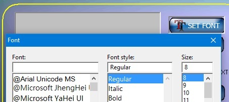

Hello,
I need a macro for Catia V5, drafting workbench..
The requirement is to change all the Geometrical tolerance Font size and Name available in the drawing, as required by the user,
Could you help me....

RE: Macro for GD&T Font Customization in Catia V5
Hello Jenial,
I have got the macro, I had an error in mentioning the Geometrical tolerance in the macro ( I mentioned it as CATDrwSearch.DrwGEometricalTolerance) , but now i had changed it to CATDrwSearch.DrwGDT, Thanks for your information.
