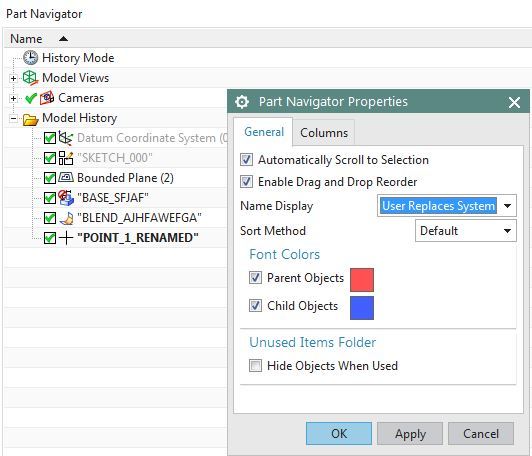

Hi all,
Is there any way to not to display the numbers after the feature names. For eg: I create 3 points in 3D. So, in part navigator Points will be created with name as Point 1, Point 2,Point 3. How can I display the names without the number?

You can't really. Of course, you could work in 'History Free' mode, but then update behavior and editing of features takes on a whole new complexion.

Yes, it´s possible!
But only if you have renamed features.

I was going to mention the 'User-Defined Names' option in my original response but suspected that that was NOT going to be what the OP was looking for.

Thanks all for the feedback.. Thanks Airin,But I knew the option which you mentioned above. But as John said, it is not actually what I was looking for. I dont want the number to be displayed without renaming the features. Thanks all for the feedback.
