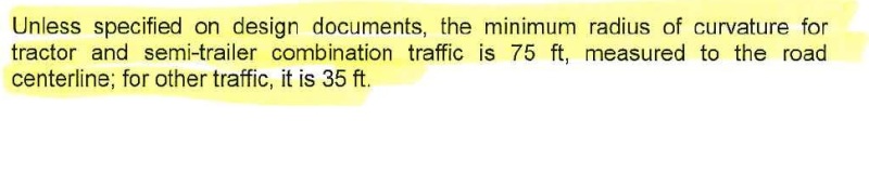

RE: minimum road width based on turning radius
@acttraffic,
This is a low volume traffic inside private industrial site.
I just saw this in client specs. So you said, I don't need 75' centerline turning radius if I use curve widening.
If the client wants the 75' radius, go with that. It will be easier to build and use less material.
