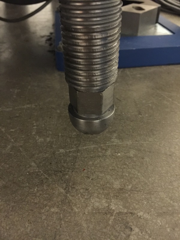

I have a very very sensitive x-ray microscope that weighs 4600 lbs. this device is designed to be move in and out of position. It is currently sitting on a 4 point kinematic mount with 4- 1" dia stainless steel balls on every corner. ( 3 corners drop into corresponding vee block and one corner sits on a flat plate) To move this device we manually crank up the ball mounts and the frame drops onto wheels so it can be moved.
The issue is that the device does not drop back into position accurately. It needs several raise and lower attempts to get it back into the vee blocks. I see there are tungsten carbide " canoe spheres" that might improve the repetitive accuracy.

> It's very likely that your balls are too small. if you assume that each contact is 1/10th inch square, you get 453MPa of contact pressure. you may want to point an inspection scope at the vees to see if they've been damaged
> we had a much lighter system, about 40 lb, on 3/8th inch balls and wound up dimpling the vees when we torqued down the bottom and top
> seems to me that if you're able to move the position by raising and lowering, then the mechanism that doing the raising and lowering might be driving the repeatability also.
> kenat's comment about sag should be taken seriously. Even steel bends, and keeping something that weights 4600 pounds stiff is challenging
> the canoe spheres seem to be a plausible way of getting a effect of larger balls without consuming the commensurate volume. wish we had thought of that 20 years ago.

Thank you for the thoughts and information. Yes I know this frame is not on a true Kinematic mount but it is what I have to live with at this time. I suspect there are several reasons for the lack of repeatability ( under size ball point, wobbling in the post that supports the balls, frame twisting, dimpled or worn vee blocks etc.) further testing is needed to determine if I am getting any rocking motion from the frame its self or other sources inside the device. ( not so easy task to get to).

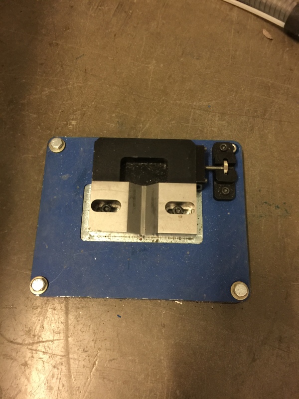

The new location that I need to move the device into is not negotiable. There will be vibration testing done next week so I will have a baseline to reference from. If I just increase the ball and groove size will this help? I do notice some wear on the vee grooves so now is the time for me to improve this design. I do not have the space to make this a 3 point mount. If I could make a new frame then I could do this but time and money do not allow this. As I said before once this device settled into position it was okay...but the repeatability was an issue. The CG is in the center.
I have attached a photo of the vee block and ball.

Don't just make the balls bigger - do the math and work out how much bigger, what shape & angle the 'V' blocks can be and what the respective materials need to be, surface finish required etc.
Hertzian contact stress isn't that complex - even I worked it out eventually.

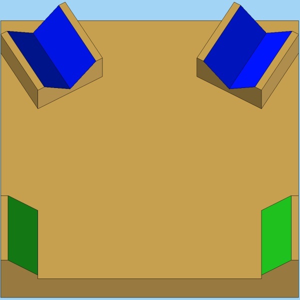

Do you have facility for balls in all four corners?
If so then as I mentioned before you can split one of the V blocks into 2 'ramps' so that all 4 corners are supported. See below image 2 blue 'v blocks' 2 green 'ramps' giving total of 6 points of contact if you have 4 balls, one in each corner of mating part.
You may need to consider the geometry for optimizing the force vectors etc.

I was doing some searching on a kinematic mount I may need to design and came across the below link:
http://www.precisionballs.com/split_vee_block.php
Points out that the spherical ball element(s) touching the split V need to be tangential to both surfaces for true kinematic/to avoid various issues. I.e ideally it would be one very big ball or truncated ball. Failing that portions of the nominally single ball.
