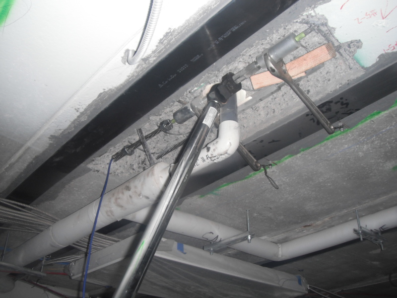

Similar to what XR250 is stating, to put some perspective to the magnitude of applied torque and resulting tension, this photo shows a 1/2" diameter 7-wire 270 ksi strand being tensioned to 25 kips using a 36" long, 600 ft-lb capacity, torque wrench. The applied torque was approx 200 ft.lb. Whilst the torque wrench was calibrated by a NIST lab, the preload was cross-checked using a vibrating wire strandmeter hooked up to a digital data-logger.
