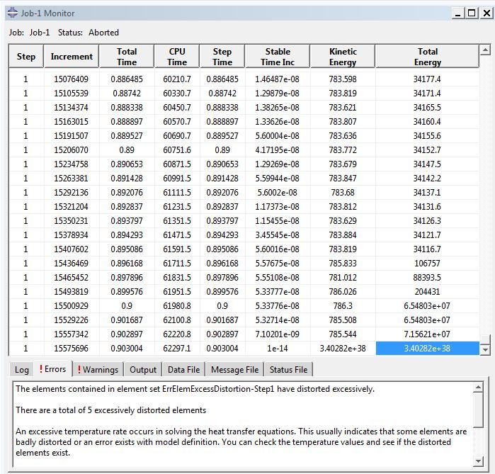

I'am simulating interaction of 2 Solid parts, and i mentioned some important parameters in below (Unfortunately I can not give full information):

Step: Dynamic, Temp-disp, Explicit

As you can see until 0.9 second everything is fine and some elements removed from model and NT11 (Nodal Temperature) is 2.334e02, and S (Mises) is 1.568e08 but in next 2 increment NT11 is 1.0083e3 and 1.330e08 also S is 8.895e08 and 1.067e10 respectively.

From other hand In last Increment some elements get black.
I never see something like that.
Is there anybody know what should i do to solve this problem ?
Should I Delete "Inelastic Heat Fraction" Behavior ?
With Best Regards.

If I were you I would start by addressing the error: "the ratio of deformation speed to wave speed exceeds 1 in at least one element".
Here is a previous post with some good tips: http://www.eng-tips.com/viewthread.cfm?qid=80443

I misplaced some of Johnson-Cook Damage parameters.
