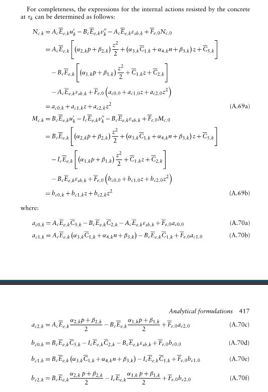

can anyone tell me what is the equation for calculating long-term deflection in post-tension and a reference please?

To undertake such a calculation you need to know a lot more about: element type (presumably beam or slab, etc), concrete properties (creep, shrinkage data), level of prestress, , reinforcement, loading history, humidity and temperature, cracking, and other factors that many PhD's have been the subject of.
Tell us a bit more about what you have and we may be able to give you a direction/path.

it`s for a slab, and I am looking for a general or any kind of equation for long-term deflection in post-tension, thank you.

it`s not a particular section that I`m working on I just need to find the equation for research purposes, if you can point me towards a source where I can find the equation I would really appreciate it.

IMO, one of the better and practical resources on time-dependent analysis of both cracked and uncracked prestressed concrete is Gilbert and Mickleborough's book "Design of Prestressed Concrete" Link
Another is "Time-Dependent Behaviour of Concrete Structures". Link

There is no "equation" for it! Just as there is no realistic equation for long term deflection for any concrete member.
Combined effects of cracking, tension stiffening, creep and shrinkage cannot be defined in an equation.

The "equation" may well be a system of equations and look a bit like below. Seriously, that's from one of the Gilbert books. And if you're conducting research, I imagine that you would want to take it that far as anything less than state of the art is probably unacceptable.
