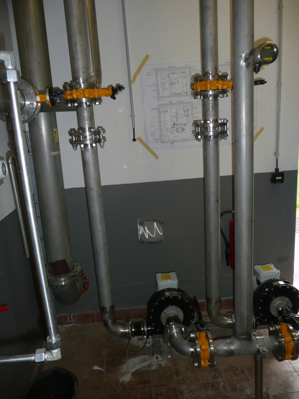

The situation is this: At a current project, there's a pair of (parallel, redundant) radial blowers to raise the gas pressure for the downstream consumers (CHP, gas burner). All vibrating machinery should be isolated from the pipeline by compensators.
Now, the installed compensators leak. New, better (stainless steel vs. thin rubber) ones have been reordered but will take a few weeks. We need to commission other machinery that depends on the blowers. So the contractor suggested the following interim workaround: Weld pieces of pipe so that the blowers are connected without compensators, install the compensators in a few weeks when they arrive.
The problem is, everybody knows that machinery needs compensators, but nobody I've asked so far has seen a blower operate without. So no one knows for sure what the problems are, and how grave.
Here's my thoughts on possible risks:
The vibrations could damage welds
The vibrations could damage gaskets
I think both are unlikely. Nevertheless, here's the mitigation so far:
  • The blowers are equipped with variable frequency drives, ramp up will be done slowly to avoid startup-shakiness
  • If there's massive vibration with the blowers running, we'll reconsider
  • After the provisional pipeworks are done, and again after the compensators are installed, there will be a pressure test
  • Further down the road, 10% of the welds will be X-rayed. I will make sure that many of those checks will cluster near the blowers
  • I'm thinking about having someone check the gaskets of the flanged connections near the blowers with leak detection spray after every or every few operation days
My question is: Did I miss a risk that's not covered by the mitigation mentioned above?

Probably terminology, but can you explain a bit further what you mean by "radial gas blower" There are many different types and some would seem to be less prone to pulsation and vibration issues than others.
"compensator" can also mean different things to different people. Do you mean a pulsation damper which is attached to the machine outlet pipe and has some sort of bladder inside or do you mean a flexible coupling such that the mechanical vibrations of the machine don't transmit into the pipework?
Have these machines been balanced and aligned correctly?
What size and wt of stainless pipe are we looking at?
It seems mechanical vibration is your issue? - This could lead to reduction in fatigue life for pipe or welds.
For the initial duration it might be an option to mount the blowers on solid foundations and remove any flexible mountings, or it could make it worse - difficult to know without trying.
Do you have a picture?
I don't like the idea of running anything in hydrocarbon service without weld examination done first, not after. That should be non negotiable IMHO.

Picture:
Pipes are DN65
This is one of the things I'd like to know. We've also discussed loosening some screws where the suction pipes are bolted to the ground, so they have more leeway (IMO the pipes on the pressure side have plenty).
The logic beeing that if we allow the pipes a longer 'lever' (= more movement near blower at lower deflection angle near where they are fixed) the stress should be lower.

This is really no more than a slightly jumped up hair dryer (750W), so I think you're overthinking this. I can't see why this should vibrate at all.
The flexible is probably a good idea to remove any vibration and also to remove any stress on the blower from pipe expansion, but could almost certainly function without it without any issue.
Just hard pipe it and get on with it. If the pipe starts vibrating, clamp it down to get rid of long unsupported lengths.

Dont see any auto remote operable emergency shutdown valves upstream or downstream of each radial blower. This is in flammable gas service. Also no check valve d/s each blower (or is this the wafer style device on the d/s side?). How will you auto stop ( from control room) and isolate this unit in case of a large gas leak in this room due to a failure of the flexible expansion bellows (regardless of whether this is made of some rubber or metal )?

Finally been on site. At least at low power, the vibrations (in the pressure pipe) are noticable but weak.
