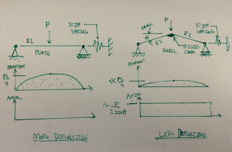

Quote (sushi)
I can sort of picture it from gut feel but can't understand why!
For a fundamental understanding, you might be best served by going back to a simple, analogous stick model as shown below. If you run this in conventional FEM software, or just in your head, you will find that the analogous "shell" on the right will deflect much less than the analogous "plate" on the left. That's because forces are generally resisted more efficiently with via pure axial strain than they are via flexural strain. That is just as true for shell elements as it is for stick elements.
