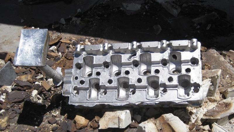

Changes from last casting:
-Made a new core box for the water jacket core. This should not have had an impact on the core blows. I had to make some minor design changes to increase the wall thickness of the casting in some areas. Also the previous core box made out of MDF was splitting all over the place. This new one is machined out of Solid Surface counter top material (acrylic).
-Used PEPSET vs sodium silicate for the water jacket core 0.8% by weight (so all sand molds and cores used PEPSET).
-Revised pouring sprue: reduced cross section to about 1" diameter, increased head to 8" from 2" and added a better pouring well.
-Pour temp 1240 deg F
The place I got the PEPSET from advised mixing at 1.5% by weight since I don't have a good mixer. With this mixture I was not having very good shakeout. I talked to a sales rep for PEPSET to ask if he had a product he could recommend for water jacket core. Based on my requirement of a hand packed core (not blown in) he said PEPSET. I told him I was not having very good shakeout and when he found out I was mixing at 1.5% he said it was too much. He said its usually used at 0.5%-1.0%. He ensured me it had great shakeout properties so I tried it for the water jacket core at 0.8% and it worked great. A few blows with a hammer to the casting and most of the core broke up and could be worked out.

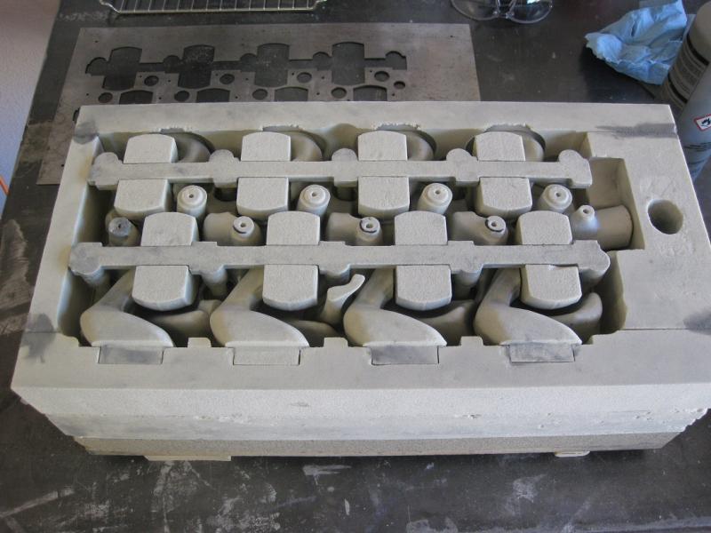

Here are some more pics.
New water jacket core box:
Water jacket sand core:

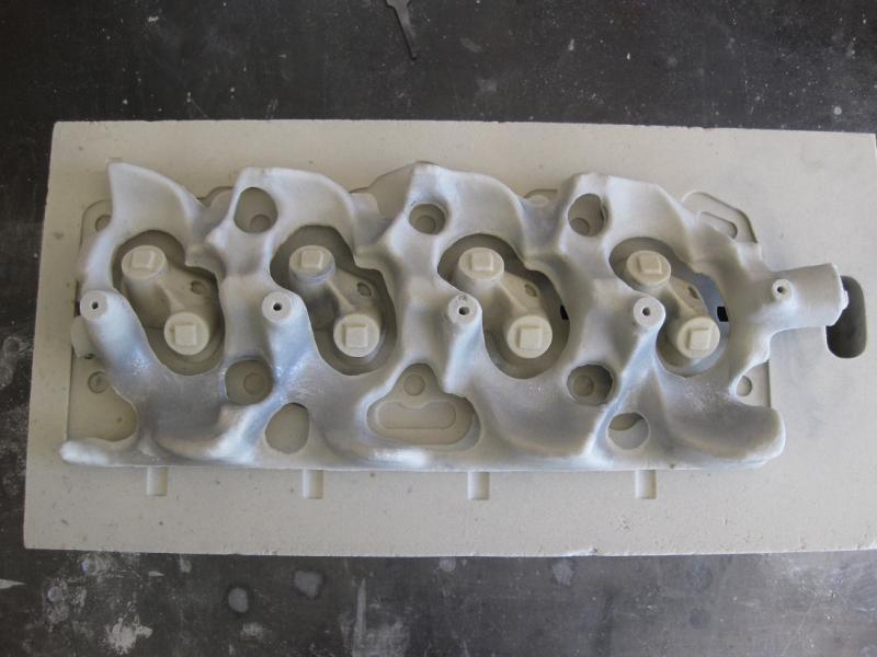

Mold/core assembly w/o top:
Mold top:

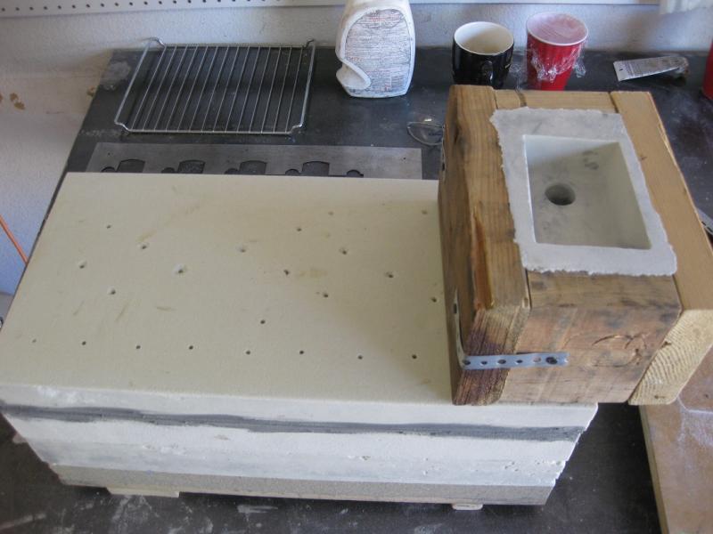

Complete mold/core assembly with new pouring sprue and well:

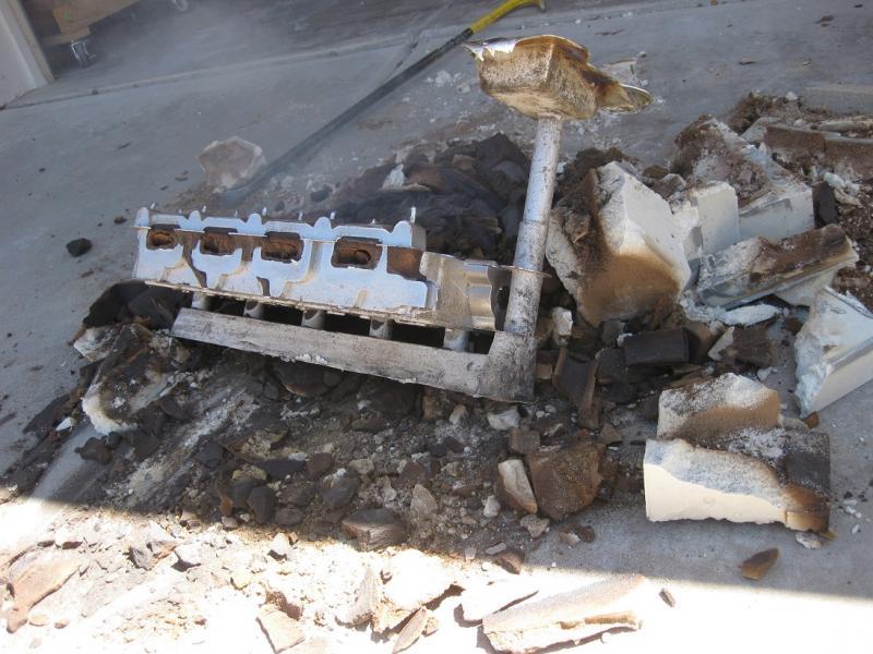

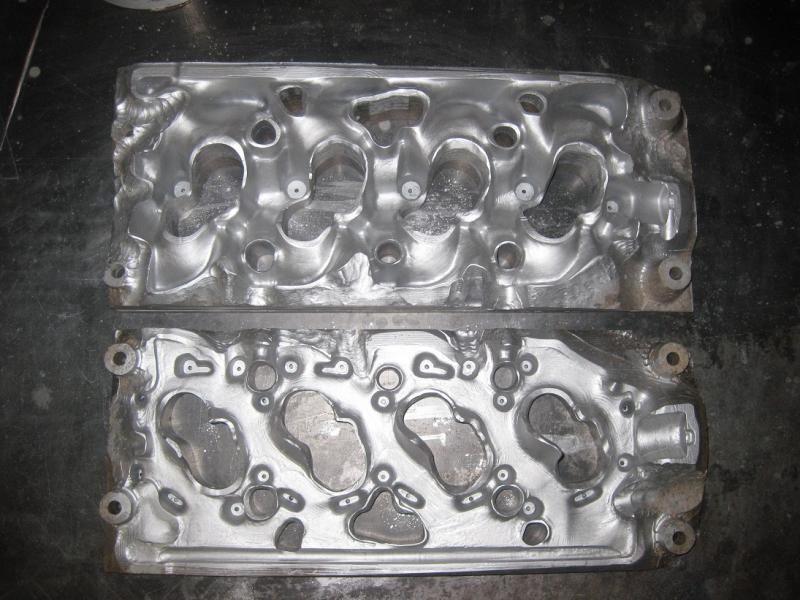

Casting:

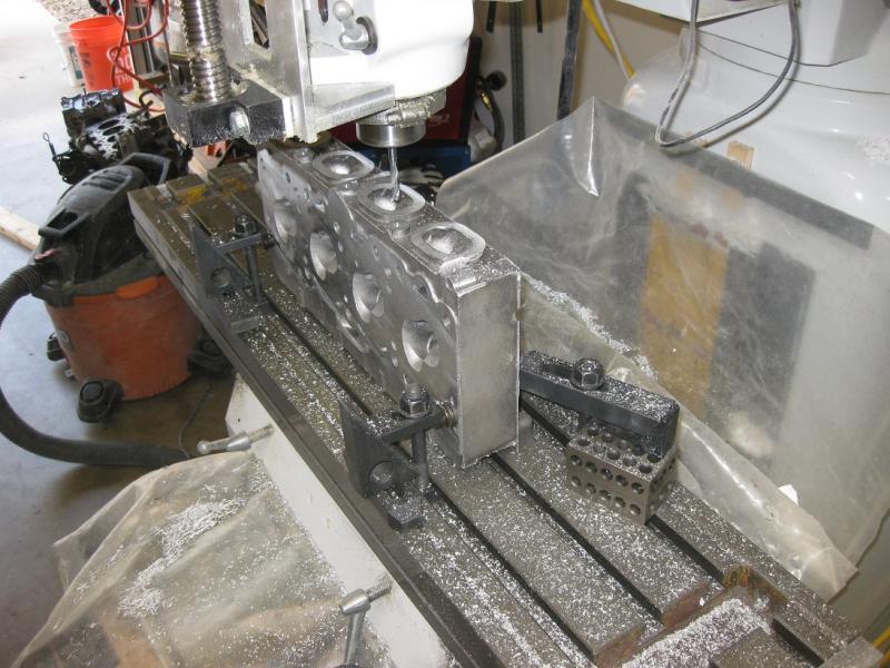

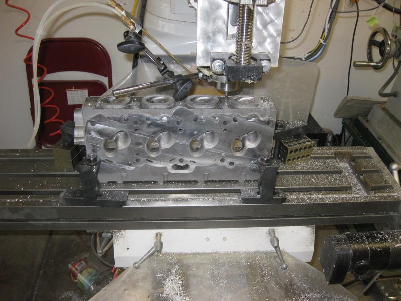

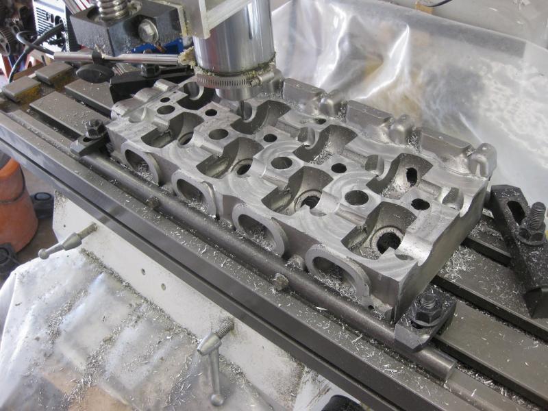

Machining:

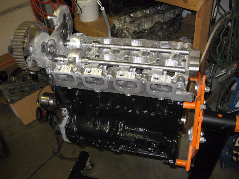

Test fitting on block:
