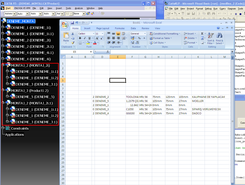

I write billof material VB code.My code is working but if I have subAssambly parts ,code is note count exactly.so how can I count my sub Assambly parts.
lNumberOfItems = oTopProduct.Products.Count
For i = 1 to lNumberOfItems
http://i.hizliresim.com/a3kGRg.jpg
https://res.cloudinary.com/engineering-com/image/upload/v1462516829/tips/catia_count_owyjm0.bmp

Could you please post the whole code? From the snippets and pictures it is really not clear what is going on ...

From what I see you are counting only parts directly below top node. If you wanna count part included in subassemblies you have to go through all children assemblies (and their children) as well. Typical example to apply recursion. If I have time later I will post an example ...

Try this:

HOW IT WORKS?
At first it creates bom dictionary and then it recursively calls ParseAssyTree routine which fills bom with part numbers. If part number does not exists in bom it is created and initialized with number 1, otherwise it is just increased by one. In the end you go through bom dictionary and print its keys and values (so part numbers and counts)

it is my code for this count.My code similar yours code.Where is the my mistake?
Dim oTopProduct As Product
Dim oDictionary
Set oTopProductDoc = CATIA.ActiveDocument
Set oTopProduct = oTopProductDoc.Product
Set oDictionary = CreateObject("Scripting.Dictionary")
i = 0
For i = 1 To lNumberOfItems
Set ItemToRename = oTopProduct.Products.Item(i)
ItemToRename.PartNumber = ItemToRename.PartNumber
If oDictionary.Exists(ItemToRename.PartNumber) = True Then
oDictionary.Item(ItemToRename.PartNumber) = oDictionary.Item(ItemToRename.PartNumber) + 1 Else
oDictionary.Add (ItemToRename.PartNumber), 1

As I told you already, you are counting parts only below top assembly level and you are not going deeper into the structure. In my code function ParseAssyTree is called recursively (ParseAssyTree is calling itself) on every assembly level for every component in the structure.
