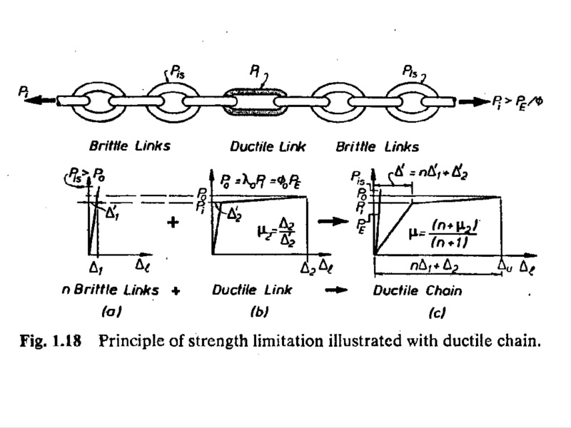

You want them to be inelastic in an event. That absorbs energy in a controlled way. Imagine a chain being pulled. You don't know what link will break. Now imagine you put a plastic link in there. You pull on it and the plastic link will break, but now you have a lot more control and the break is gradual and absorbs energy. Same concept with high R values, you put in a controlled weak link, but certain parts have to be over designed such that they aren't the weak link.
For example, connections have to typically be way over designed so that they aren't the weak link because it would be sudden. Yielding of steel is what you want, not connection failure, etc.

Imagine a braced frame where you design the brace to deform inelastically. Now imagine you didn't design the connection to transfer that higher load. At that point, who cares about the brace if the connection fails and the brace can't absorb the energy?
And remember, structures don't know what code they are designed to. R factors and over strength factors are approximate and educated guesses. Point of overstrength factors as I see them is to make sure the load gets dumped into the main lateral system, and that the lateral system is designed and detailed in such a manner to behave inelastically in a controlled manner, again the chain analogy. Connections, collectors, etc. that dump load into the system are critical, because if the load can't get into the lateral system it won't matter if you have a "weak link" there

Tom Paulay used the chain analogy way back when...but no 'plastic' links in his!
RE: Overstrength and Inelastic Response
I definitely stole the chain concept from someone. Can't remember where, but someone taught me that and it made perfect sense so I haven't forgotten it!

From Paulay and Priestley's book "Seismic Design of Reinforced Concrete and Masonry Buildings":
That graphic seems similar to springs in series, where the least stiff element controls the majority of the deformation of the system.

In one version of Paulay's chain analogy, I'm pretty sure that it was presented with cast iron links and a single mild steel ring which I like even better.
