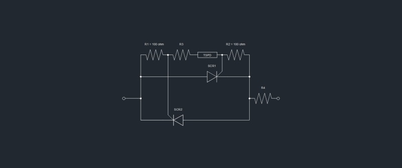

If you want to roll your own poor mans version of that Siemens product then put a pair of SCR's back to back. Use a 100 ohm resistor between the gate and cathode of each SCR and a thyristor surge protection device (TSPD) and resistor in series between the gates. Pick the TSPD Vdrm to be around 1.2 times the peak of the AC supply voltage. The series resistor is to limit the peak gate current to around 1-2A. Put this circuit in series with a power resistor to absorb the energy.

Thanks for the info. The below image file is what I came up with. Please let me know if it looks about right?

That looks right. You could probably throw a diode across each cathode-gate to limit the reverse voltage.
