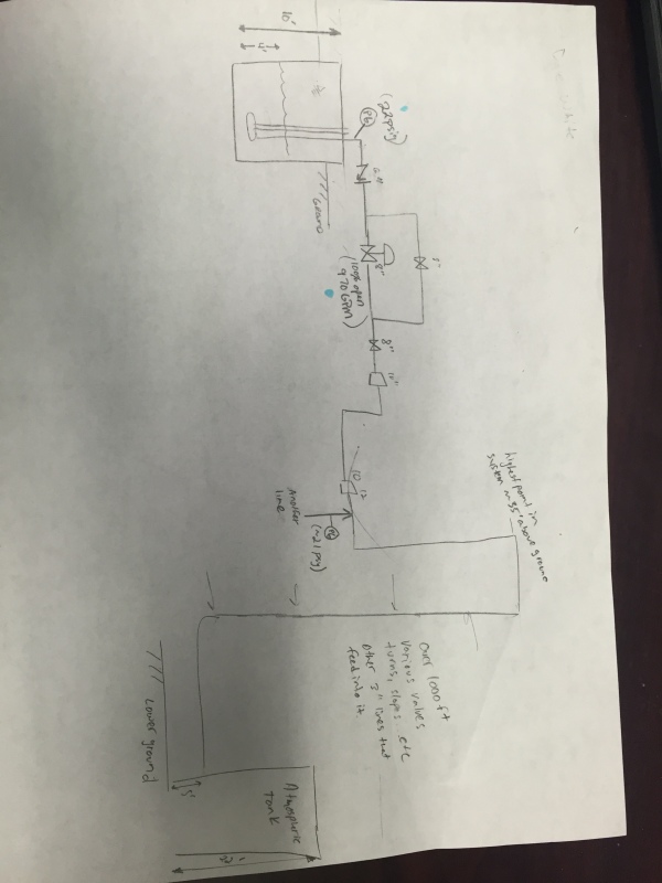

Out in the field I had the operators open the discharge control valve completely with one the primary pump running. This results in a reading of 22 psig which is roughly 51ft of head (considering its mostly water) at a flow rate of 970 GPM. Since the pressure gauge on the discharge is about 11' up from the center line of the vertical pumps impeller, I would add that to my total correct? So my pump is producing roughly 61ft of head at 970 GPM? Even then, it is still off the curve a bit, could this be due to impeller wear?
I've also attached a rough layout. Another question was when you have multiple lines that come into the main 12" waste header is it ok to disregard them since they are just 3" lines mostly?
-LittleInch what did you mean by d/s?
Thanks again guys. Just trying to size create an accurate system curve so I can move forward. Not asking anyone here to do it for me.

Frank217. You can´t produce a system curve with the control valve variability. As the control valve closes, the system curve gets steeper. It´s not a fixed "system". Firstly though you need to determine you static head. At least that point won´t change. It´s on the left hand axis at about 40-45 feet I suppose looking at your sketch. The system curve sweeps up from there. The throttling on one pump will reduce the flow to your minimum, and the pump discharge pressure will increase along the pump curve to the left, as the valve closes.
Interesting to know whether you have a vent at the high point. The downhill run static head then won´t play a part. If the downhill run is a "launder" type flow with enough air getting in, then likewise, the static head after the high point does not count. You only need to worry about static to the high point. This is the limit of the pumping duty, "probably" (there is still missing information in your sketch).
Don´t worry about the 3 inch branches feeding in. They are nothing.
You may be right about oversize pumping for the minimum flow case. But it may be that the control valve is causing issues. I would have preferred a fixed restriction in the form of a separate bypass line around the main control valve for when ONE pump is operating (could be orifice plate, or small bore line). Then when you operate two pumps you can start using the main control valve again. Just a thought and a bit of a guess without having all the data.

So my static head would be the high point of the system (adding on the suction light height so 35+10)? I've gotten numerous feedback on this, some say it would be just the vertical distance (difference) between the suction tank level and discharge tank level. I don't know this precisely yet but that value would be very small if not negative. Any clarification? Thank you for the feedback again everyone.
RE: Sump Pump Issue
It's a bit odd, but to get any flow, you need to have at least the head to get over your high point. The problem then comes as flow increases.
You need to get a proper profile drawing, distance along the x axis and height on the y. Then plot the head loss line from your pump to the surface of the tank at the far end. If this line is above the high point, then the "static head" at that flow is your negative figure.
If your hydraulic line intersects the ground level then you are probably working in slack flow and the static head is still the height of the high point. I don't have a scanner wher ei am at the moment to sketch this out, but

I'm quite unfamiliar with these hydraulic profile lines. Doing some homework on it now. When sketching the profile, are they different points just calculated at different elevations throughout the system?
RE: Sump Pump Issue
For liquid flow you only really need the hydraulic head at the start point and the head at the end point and then draw a straight line. For the ground elevation profile to be drawn on the same graph you need as many points as you can get.
So e.g. if your pump elevation is at say 50m above sea level (asl), you start at 50 at kp O and then add the hydraulic head ( say 40m ) = 90m. That's one end. At the other end the elevation is 40m and you arrive at a head of 10m. The other end of your line is at 50m asl( kp 3000m). Just draw a line between the two.
It should always be above the ground profile.
