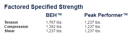

Quote (mike)
What are the disadvantages to using those comnectors?
Speaking as a former wood truss guy, my issue is the interplay between joint stability and quality control. As the designer, you'll get spiffy values to work with as shown below (Mitek Website). I'm sure that tension and shear are fine. Compression capacity, however, will have everything to do with the size of the gap and the degree of initial imperfection present at the time of fabrication. I've no doubt that the published compression capacity comes with a particular limit on the size of the gap. However:
1) Does the designer, often not an engineer, know the limits on the gap and why that's important? Or is it in fine print some place?
2) Do the non-english speaking folks putting the truss together know the limits of the gap?
3) Does the truss installer whole may be doing some of his own truss assembly know or care about the limits of the gap?
4) As a former shop laborer, I can also tell you that the hinge plate is a convenient place to bury any tolerance issues that you may be having.
5) If you don't have your truss roller/press machine calibrated just right, you'll end up shipping these things out all bent up to start.
Like I said, for overbuild situations where your not really dealing with true top chord compression forces, I think the hinge plates are a spiffy idea. For compression members that are part of real "truss", I'm pretty skeptical in the absence of uncommon MPCWT quality control.
