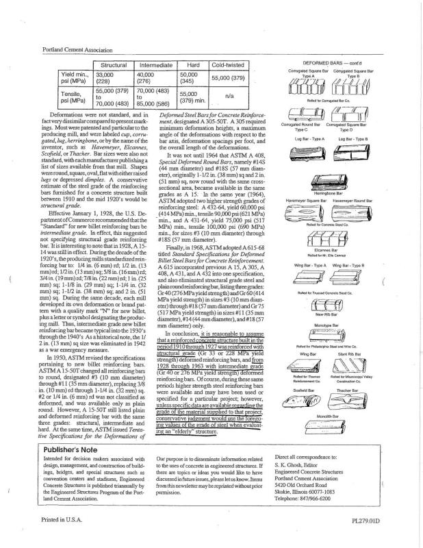

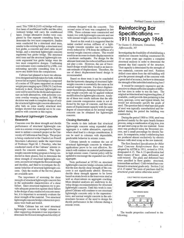

Check out this article - specifically the last paragraphs. See if this helps.
Page 1:
