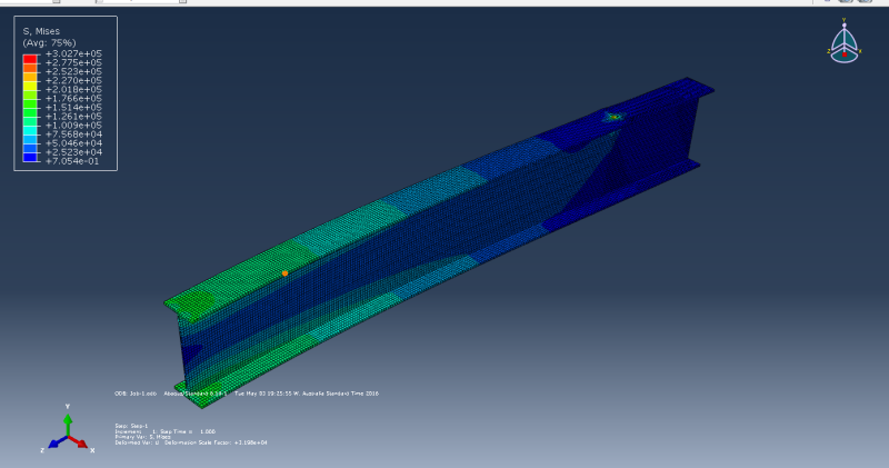

Hey guys,
We are trying to analyse the bending of an horizontal I-beam that is attached to a ENCASTRE (fixed) end. Imagine it being bolted onto a wall, and then a point load of 20 kN is applied.

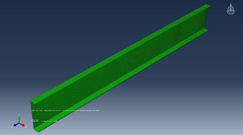

So we are now trying to split the beam in half, and model it on ABAQUS to help with processing time. We would then half the point load to 10kN. Here is a picture of the model on ABAQUS:
Now here is the full beam on ABAQUS:
We found that the Mises stress is different- maybe its caused by torsion or eccentricity of the beam? Do you guys have any idea why the results are different and how we can fix it on ABAQUS?

RE: I Beam analysis - splitting into half and halving load yields different results to a full beam
- added symmetry constraint?
- useful element type?
- how is the load applied?
- what is that stress concentration on the full beam?
- is U1 equal between the models?
how do you account for the symmetry of the full beam, compared with the asymmetry of the 1/2 model ?
Restrain the cut plane in the x direction for symmetry.
Elaborating on Corus's comment.  You should restrain all nodes on the symmetry plane against X-translation, YY-rotation, and ZZ-rotation.
Denial, As far as I can make out it's a solid model so there are no rotational dof. You'd be correct if it was a shell model.

@corus ... so constraining the translational freedom should be sufficient, in this case.
@greg ... it would appear so ...
RB1957.  If your comment to Corus was a question, the answer is "yes".

That being said as Corus said, the solution is to apply a fixture in the x-direction which creates a symmetry condition. Since symmetry is essentially having equal and opposite geometry and loading, the forces that pull that center line out of plane, will be resisted and the reactions on that fixture should be equal to what you would get if you sectioned it and used statics to calculate the internal forces at the center. Using FEA tools does go hand in hand with understanding how to calculate things by hand. In this case, I'm assuming you are learning the tool, since this is a simple problem. So make sure you check that you are in the ballpark of normal stress in the z-direction by doing a hand calculation on the bending stresses.
As analyses get more complex, I always start simple. Make sure the geometry is correct. Run a simple load case (Point load/Uniformly Distributed). Check it against a hand-calc. This proves out the material properties and the softwares settings. From there I add more detail to the geometry of the model and detail to the loading if necessary. Anytime I'm unsure, I double check everything (model, materials, settings). The easiest way to make sure everything is working is to start simple and build more detail to your model.
