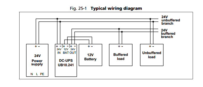

Ok... I will try to explain more parameter must be considering:
When you turn the truck on the system voltage is drop down because of the starter motor (there are 2 like those in those trucks, starting current about 400 ampers each)
the system voltage and the charging voltage from the alternator is 24 V - I cann't connect any 12 V battery to the system. and I don't want to drain the battery system while the truck is off.
I want to make sure the PC and the modem stays on constantly.
I cann't connect just a step-down DC - DC inverter because then I will drain the batteries.
therfore what became the best solution for this is a DC-UPS system with independment 12 V battery. but the issue now is about finding a shelf solution that capable to work in those conditions, such as high vibrations and corosive enviorment.
I'm atteching one of the DC-UPS wiring solution
Many thanks to all you!
RE: Uninterruptible power supply for PC and cellular modem running on haul truck
The concern about draining the vehicle's battery...
Use a 'Switched' 24-volt power source (found in the vehicle's fuse box) that's only on when the vehicle is on / running. Do NOT connect directly to the vehicle's 24-volt battery.
This obvious and rather trivial power source wiring suggestion fully addresses this issue about draining the vehicle's battery.
Does this make sense?
Obviously, the subsequent 'UPS' will require and must have its own 12-volt battery.
Therefore, the only thing that's actually required (the conceptual 'UPS') is a battery charger that can charge the new 12-volt battery while being powered by 24-volts.
That's your 'UPS'.
Done.
As your load appears to be 24V DC, you might consider using a split charge system with an independent battery for the load (the 'UPS' battery in the sketch above). What you're doing looks like a leisure battery system from the RV world. First google hit I got is typical - I've no connection to this company other than through Google.
At the top, OP wrote "a PC and cellular modem on haul truck - both components are 12 Vdc input".
The diagram seems to be just in support of the discussion.
Thank you everyone
I will look for shelf solution for this one.
if you want to know more about what I looking at you can check the attechment
1
I'll realy appritiate it if you will take a moment to check this with me.
