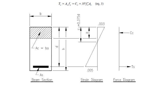

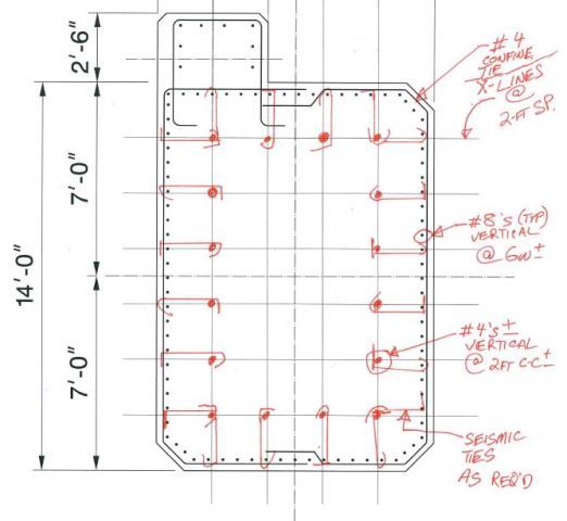

I am looking at the proposed replacement of an existing bridge pier column. The cross section I'm looking at is large (approx. 10-ft x 14-ft). Even when using reduced section/strength properties similar to ACI (318-08, 10.8.4), initial analyses indicate that the section is adequate with only 33% reinforcing steel.
Looking at a rough sketch of the cross section, it doesn't seem like it should be enough steel, but looking at the size and spacing of the bars, it seems like it would be excessive. So part of me is starting to question if using the classical stress-strain relations for bending would still apply for a column of this size.
Does anybody know of any references or specifications that discuss bending of large concrete columns and minimum steel requirements?

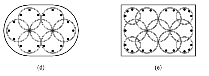

I don't no much about bridges or huge concrete columns. But, has any consideration been given for the ties? Does AASHTO or other bridge codes have different requirements than ACI 318? If not, it might be worth considering an equivalent circular section using spirals or circular ties. Last year, I saw and article,Seismic Performance of Concrete Columns with Innovative Seven- and Eleven-Spiral Reinforcement , in ACI Structural Journal about columns with overlapping (interlocking) spirals (I just looked at it quickly because I don't do bridges).
RE: Large Concrete Column, < 1% Reinforcing
Quote (wannabeSE)
That is a LOT of spirals!

And just thinking about it, an inner layer of bars could also make tie placement a little easier. Though I'm not aware of any widespread DOT uses of that approach. Does anyone know of some "standard" DOT column details that use two layers of rebar?

No standard details I know of. If I were going to use two layers I would have several pairs of stirrups that overlapped with each other and the rebar on the inside layer would line up with the outside layer. I don't have access to a scanner at the moment, but the stirrups would overlap in the 14' dimension and be full height in the short dimension of the column.
In the sketch you shown I don't know if your confinement ties would be adequate. I don't remember what AASHTO says right off hand. I was thinking the ties had to have 135^ hooks.

Something of that size just kind of begs for just treating a perimeter width as effective only......while the interior is just fill (for structural design purposes). I don't know if AASHTO allows that, but as jed alluded to above, it's a fairly common thing to see in the power business. You would have to be sure not to anchor/sit anything anything in a unreinforced zone.
