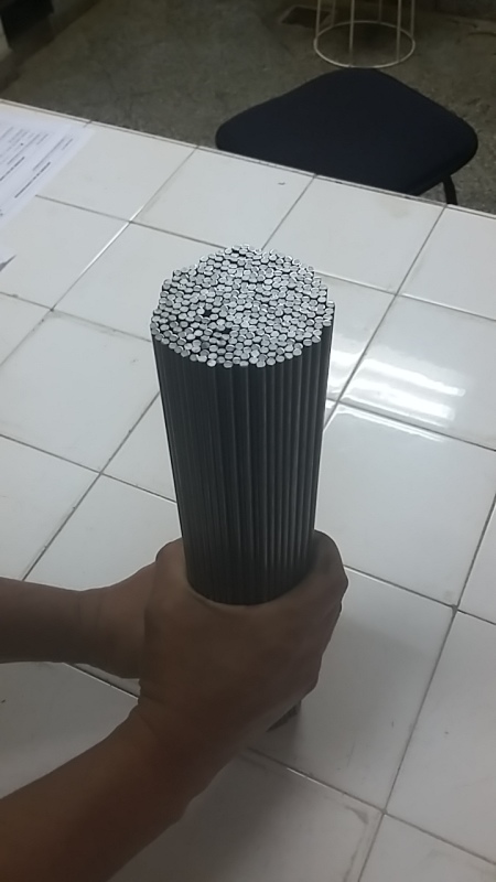

The end product is 350 mm straightened wire to be used in the production of welding electrodes

The wire is fed continuously but it hits a stop to prepare the wire for the next cut. The wire is pulled from a wire coil through several grooved rollers (feed rollers) and there is a little slippage between wire and roller until it gets cutted. I Hope my explanation is understood
