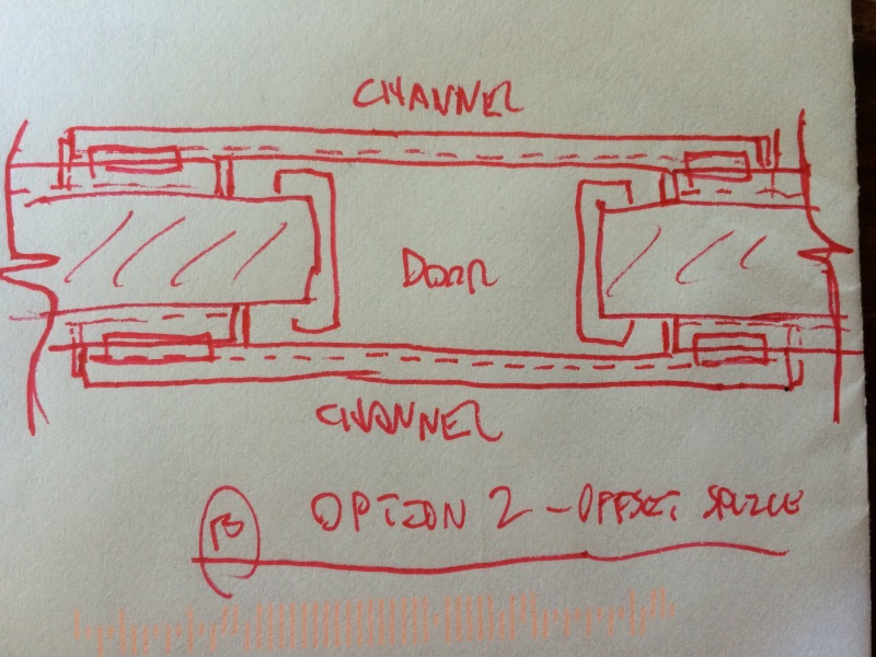

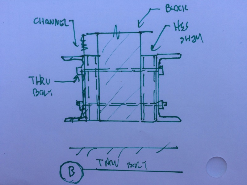

Through bolting with some HSS shimming sounds like the way to go even if the capacity determination is sketchy. I've often wondered if one could through bolt but still full the cavities with that same HY70 goo but I haven't gotten around to querying Hilti about that.

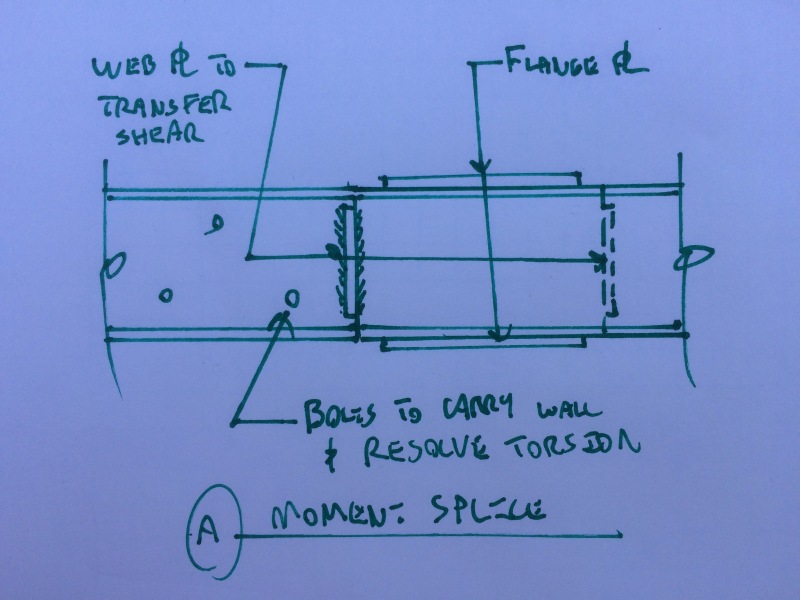

Here's another option. Moment splices either side of the door.

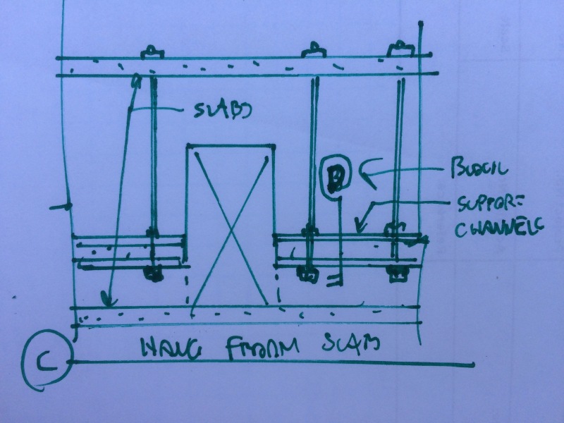

What's wrong with bracing that channel up from the floor on the ends with minimal attachment to the block then needed?

1) your moment connection is very innovative! But the offset of the channel at the moment connection may be problematic. Will that cause moment about the weak axis, and horizontal deflection?
2) I am not following how the HSS would be used to shim the thru bolt.
To oldestguy - the floor is all being removed and rebuilt, so I do not think that anything can be supported from the floor.

I sketched up the moment splice in detail A below. There would be torsion but a) It would be quickly resolved as wall flexure via nearby bolted connections to the wall and) I'm guessing your design is deflection governed and stresses are pretty low across the board. I wouldn't even bother to investigate torsion.
The HSS shim idea is show in detail B.

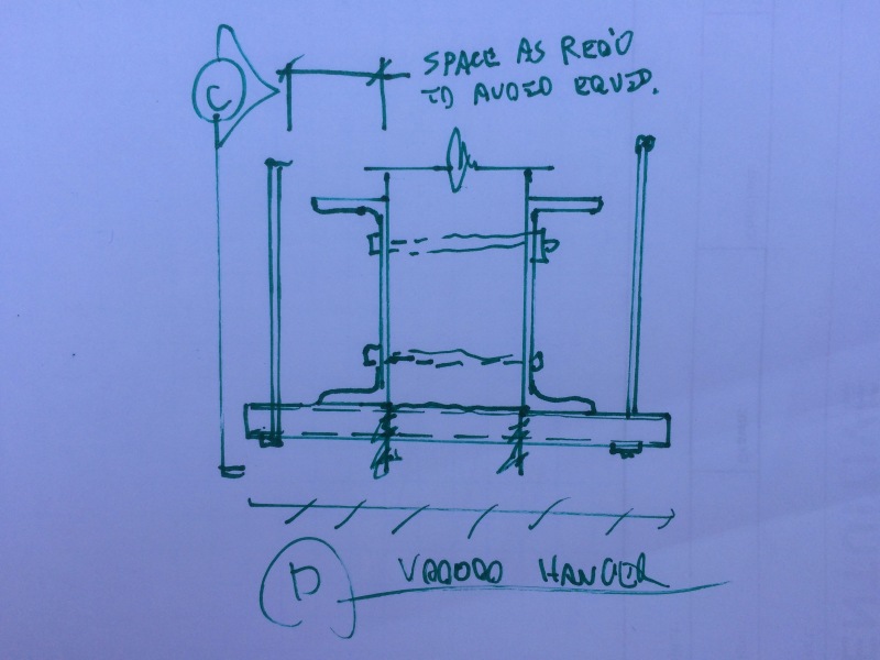

Details C and D show a system hung from the slab above which, I believe, was a previous proposal of your own devising. It would eliminate the door frame issue handily as the channels could stop either side of the door.

Voodoo Hanger is a great name for a detail!. I always try to slip in a few odd names or words but that's a good one. I've managed to get into print drawings calling a big upside down "U" shape thing the "telephone". Also designed a big cart to remove a piece of eqpt walled a "wye" and called it the "Wye-Mobile".
