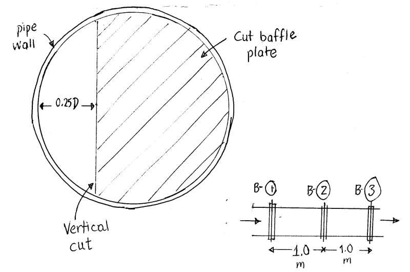

A couple of sharp turns in the mix gas stream should help to get good mixing without losing much on dp - install say 3 vertically cut baffle plates at 0.5-1.0m intervals, with say a 20-30% cut dia on each - that should do it.

Here is a simple sketch
RE: mitigate H2s content
Baffle arrangement is similar to that for crossflow baffles in a regular shell and tube heat exchanger.
Am assuming these 2 streams would be mixed well before the amine absorber, so these divertor mixing baffles should be some distance upstream of the absorber.
Dont see why this wouldnt work - it also avoids concerns with blockage that you would get with a conventional static mixer when mixing solids bearing streams. You could mix these streams with the mixing venturi you've proposed, but I dont see why you need to make all this extra effort for what is a simple mixing operation in gas service.
We had a similar operation in the concept design for an offshore gas field in the South China Sea in 2008-9 for diluting a sour gas stream with a sweet gas stream to keep out of NACE MR01-75 limits, and I had recommended this approach - dont remember now what the project design team finally adopted.
