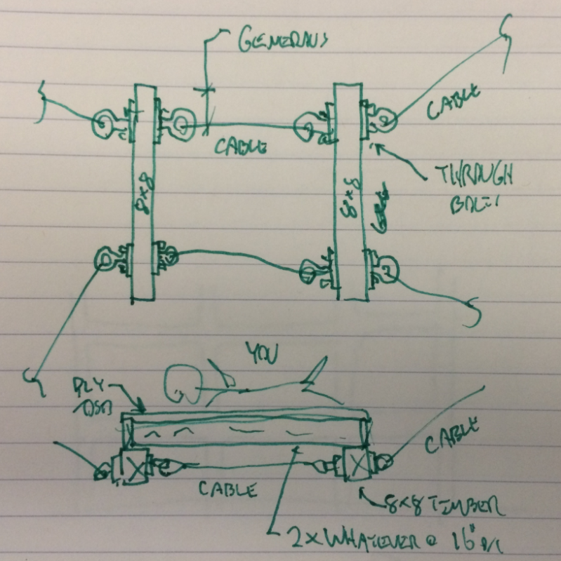

I am planning on building a tent platform that will hang from four trees. My plan is a 10'x10' platform constructed with 2x8s with 15" center to center joist spacing. Flooring will be the lightest plywood I can find. Will this platform be structurally sound if hung by all four corners, especially if the strain is not 100% vertical, but more along the lines of 45 deg.? All the platform will hold is a mattress and myself with a simple A-frame covered in shrink which I don't anticipate will add to the weight significantly. I'm planning on using four 1-ton come-alongs in each corner with 3/16 galvanized cable.
My fear is that the horizontal component of the wire strain will prove problematic, but I may be mistaken. Any specific building additions/precautions I need to include?
Any advice would be greatly appreciated.

You're right, the angled cables will pull things apart. Put tension cables between the hooks where they connect to the platform. There will still be lateral forces in the cable which the trees will have to support. The tree will tell you if it is not happy with your cable arrangement. When I hung things from trees as a kid, we used old seat belt webbing to wrap around the branches and hang things from and protect the tree. We even bolted it to hanging beams - amazing stuff.

If it were me a fundamental element of my design would be that the wires going into the trees would go under the platform and "cradle" it. Seems like that would reduce stress on the platform and help prevent twisting and tearing. If it were me I'd design an extra solid square 6x6 frame, have the wires go under that and be positioned onto the 6x6 frame with heavy "U" bolts at the corners. Once they were all together you could tension or relax the wires to level the platform. Then designing the top wouldn't be any more complex of a problem than designing a free-standing deck sitting inches off the ground with concrete blocks under the corners.

I do think that the horizontal component of the cables may cause problems. I've proposed a beefier thing below. It's quite similar to earthsuntech's concept I think.
RE: Structural integrity of a hanging tent platform
Earthsuntech & KootK-- ahhh both of these designs are going to help me sleep at night.. While I'm 10' in the air :)!! Earthsuntech, that design was exactly what I had in mind but hadn't thought to run the cables under the platform to cradle it-- perfect. I'll follow one of these concepts depending if I can find the proper tree orientation to allow for the cables to cross close enough to 90deg at the center of the platform.

Tree platform frame 1 -> 9 - http://earthsunfarms.com/Tree_Platform/
Wouldn't rely on a single bolt to hold the 6x6 frame together, throw some some addt'l hardware in there. Also, I'd use fender washers and double up the nuts with the 2nd one being a nyloc and tightening them against each other. If you want to get picky for press treated lumber you should use galvanized rather zinc coated hardware. You'll easily cut yourself fooling with cut braided metal cable/rope and I'd use something substantial like 1/2 or 5/8. Once the cable is threaded through the eyebolts you can level the platform and seize the cable with a pinching device at the eyebolts. Construction of any kind of platform desired with whatever lumber you like would be easy on a pre-hung frame.

earthsuntech -
Not comfortable with the end condition for those eyebolts.
Lots of eccentricity too (relatively speaking).
Seems like tear-out would be a problem.

I have three words of advise: free body diagram

HouseBoy - thoroughly agree. Yeah, I was just coming back in to post that 8x8s are nice but more expensive and much heavier, and looking at KootK's drawing and I like that also. Absolutely those eyebolts could tear out but I believe it could be made to work with more reinforcing. 8x6s?

I say "cut out the middle man". I would not even want to introduce the steel eyebolt-to-wood connection. Keep the tension in the steel and trim the wood materials down to minimum.
The real question boils down to understanding what the actual forces are.
That's why I say free body diagram will be essential here.

Keep tension in cables. Be weary of eyebolts. Free body diagrams. Got it!
Earthsuntech-
Thank you for those diagrams-- very helpful to visualize. "Crushed like it was made in tooth picks in heavy winds"-- maybe I'll have to relocate during storms or maybe that's part of the thrill of being alive!
I'll be back at the land in a little over a week and can get a better idea of the tree orientation I'm working with so I can make a wire cradle work. Will start constructing shortly thereafter-- pics to follow!
