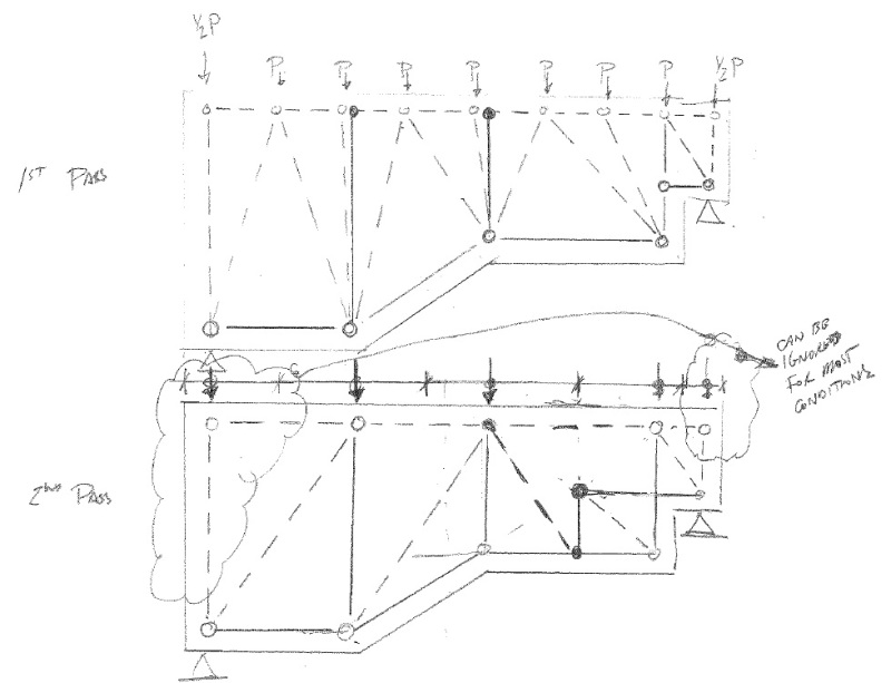

I am studying the concept of strut and tie method and modelled an rc wall and try to figure out the correct truss model for the STM.
I have the following questions;
1. How do you normally size the strut? looking at some examples, if the point load is coming from the column, it is quite easy just simply relate it to the size of the column, but how about if you have a "line load", I've just converted the line load to a point load(pls. see attached.
2. When you have a line load, and you intent to convert it to 2 point loads on top of the rc wall, normally, you just take half & half approach(pls. see attachment, in the line load diagram, I enclosed in "red" line load converted in to point loads). But how about the other "halves" outside the "red zone" do I need to include them as well?or just simply leave it according to my model?
3. Based on the result that I've got(Black (Tension), Green(Comp), Red(Reactions)). How do you provide "matching" reinforcement for this?
Any ideas/suggestions are highly appreciated.

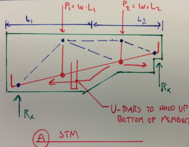

1. One way is to have regularly spaced nodes along the loaded edge with equal point loads applied based on that spacing. The way you have it is fine except that the left and right edges should have a vertical strut to carry some of the load. As shown, you are being more conservative. One test is to check if the reactions on your supports are the same as modeled vs with a line load.
2. Do not just take half and half. Loads should be proportioned based on the nodes tributary width (half the distance between adjacent nodes - add left and right nodes).
3. You are working backwards. Pick where you want reinforcing first. Then create a strut and tie model with the ties matching your reinforcement locations. In your case, the right side reinforcement would probably placed horizontal with a hanger/corbel bracket at the dapped end. The STM will need more nodes here to include this flow of tension. In concrete, it is usually cost effective to benefit ease of construction over less material (concrete and rebar).

I don't normally advocate non-orthogonal reinforcement but, in this instance, I think that it might be a worthwhile simplification.
I'd assign the distributed loads to the nodes as I've shown below. With the uniform loads at the far ends, you just want to set things up so that those loads are accounted for in the nodal and bearing checks at the reaction points. What I've shown will be a little conservative for moment and shear but will prevent you from having to deal with the complex C-C-T nodes at the bearing points that you'll end up with if you add extra members to the ends of the truss.

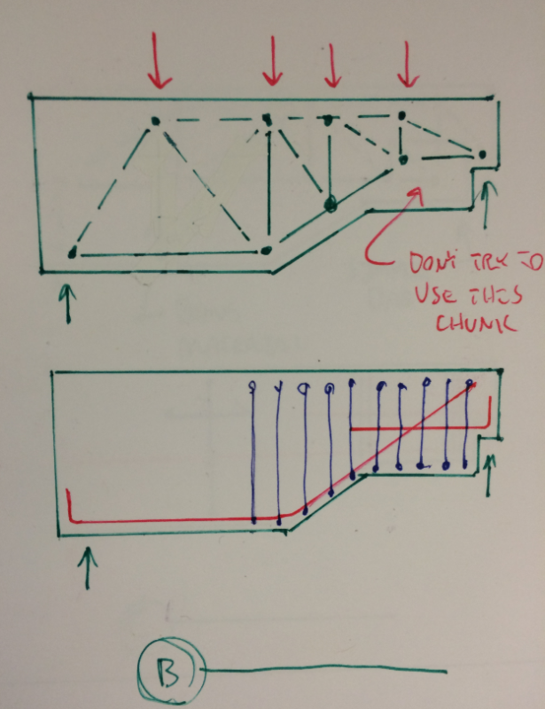

Some more rules of thumb -
1. struts run parallel with cracks. If you know or expect where a crack will appear, run your struts parallel with that expected crack. In this case, we know how dapped ends crack so we don't put a strut running from the top node down and to the left in the dapped area.
2. Corollary, struts do not run across cracks. Ties will need to cross cracks.
3. Corollary to corollary - struts and ties can't be in line next to each other. Struts shrink and ties stretch and concrete's shear capacity is finite.
4. Sum of external forces and moments will be exactly resisted by the internal forces and moments at every section along an STM. This can help locate nodes in tricky areas.

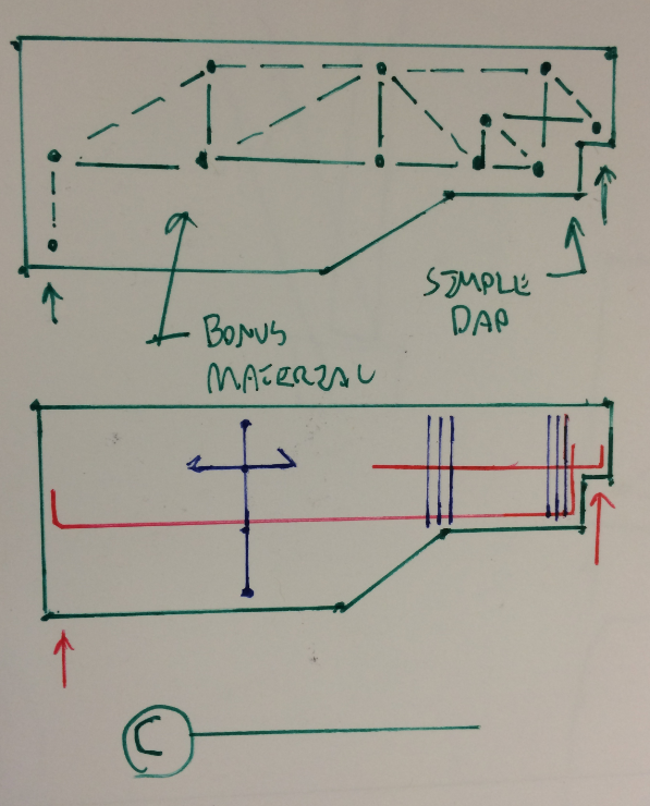

I would also be perfectly happy with either of the two simplifications shown below provided that you had some healthy crack control reinforcing in the bits of concrete outside of the truss proper.

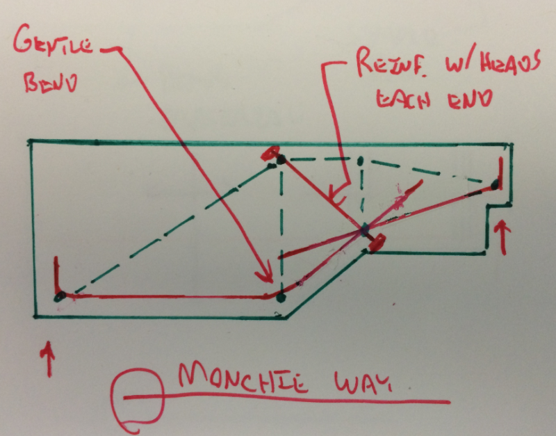

Quote (Monchie)
Were I to attempt to reinforce your STM, I'd do something like what I've shown below. I do think that there are more advantageous models for you to use however (we've covered them above).
