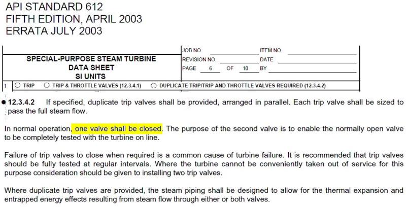

I am now busy with the evaluation of a steam turbine in the refinery project. The question that I have is that Client asked DUPLICATE Trip/Throttle valves. I would like to know what this type of valve is or if somebody can send me more information/schematic about this type of valve.

When I read duplicate trip valves, I am thinking of two trip valves in parallel. This arrangement can be used so that a full stroke test can be performed with the unit on-line. If a system needs to be rated a SIL 3 or 4 to address process safety risk, a full stroke test may be required. For a process that only shuts down once every 5 or 6 years, this would require dual trip valves. We don't have any systems with this set-up. But, I have heard of this arrangement at other facilities.

Thanks for all the input with regard to my question. Actually the wording "DUPLICATE" is specified in API Data sheet. In page 6 of API 61S data sheet, there are 3 choices for T/T/ valves. One of them is DUPLICATE type. That's why I raised this question. I think Johnny response is more close to the meaning of DUPLICATE.

I didn't work industrial size units so the I am not familiar with the API standards. finding the data sheet on line, it refers to the standard section which defines the DUPLICATE as using two 100% in parallel so that online full closure testing can be performed if the unit is not routinely removed from service.
I highlighted the part of standby valve being closed as the use of multiple stop valves was used by utility size units, but both were open during operation
