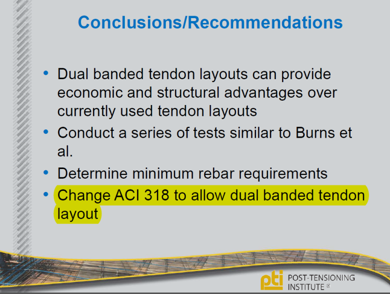

Does ACI allow for dual banded system in two way PT Floors ?

Quote (OP)
Not as of ACI 2011. That document states that, for uniform loads, tendons in at least one direction must be spaced at no more than 5' o/c or eight times the slab thickness.
Double banded systems have been used in the past, however, and some folks are interested in bringing them back.

Kootk,
18.12.4 does not preclude the use of banded/distributed in both directions. As the commentary states the spacing limitation permits the use of banded in one direction which would otherwise not be acceptable in a 2way slab system as it is essentially a one way solution.
As long as the tendon spacing is not > 8 times slab thickness in one direction, 2 way banded/distributed is allowed as well by this clause. Normally we would modify the spacing limits for 2 way banded/distributed to 6 times slab thickness in the column strips (which are carrying more than the average load) and 10 times slab thickness in the middle strips (where there is a 2 way pattern of tendons allowing a higher spacing than would be allowed for a one way pattern) (refer TR43 and AS3600). But if someone wants to be pedantic they can apply the 8 times limit.

Quote (rapt)
Agreed. But it does preclude the use of 100% banded / 100% banded which is what "dual banded" means to me. Perhaps zineelabedine can clarify what his intended system was.

Kootk,
Actually, banded/Banded with no middle strip tendons is normally an accepted method as well. The bands provide the column strips and the slab between the bands is designed as an 2 way RC slab so the reinforcement covers the spacing problem. This was called "support strip" prestressing in the old days and was used in Netherlands in the 1970-80's. I could never understand the advantage myself.
The only layout that should be rejected outright is distributed/distributed as it does not provide a load balance or load path for the prestress, though it can be made to work with FEM analysis and good detailed design (no averaging simplifications etc) allowing appropriately for cracking etc and long term deflections.

I actually meant banded/banded without a middle strip tendons, sorry for causing any confusion.

Why would you want to do it?
What is going to provide load carrying capacity and crack control in the remainder of the slab between the bands? As I mentioned above, this can be done by reinforcing the remainder of the slab as =RC two way slab spanning to the bands. But then you are doubling up on reinforcement.
The ACI logic (lack of logic) that says that the locations of the tendons across the width of a panel does not affect the slab capacity is very dangerous. It requires a proper load balance distribution of the prestress and banded/banded is not a load balance distribution. And the ACI logic can require a lot of unaccounted for redistribution to make it all work. It has also led to the "average moment" design logic for service stresses which results in the significant underestimation of service stress and cracking and deflection calculation. Ductility problems also as you are not considering the concentrated stresses near the columns. And then people do it with drop panels and significantly underestimate the strength of PT slabs (15-20% under!!). It also does not allow the use of partial prestress design as you are not dealing with real stress and strains so cannot calculate crack widths or deflections properly.
In the hands of people who do not really understand what they are doing, it is dangerous.
Column/middle strip in both directions is a load balance pattern and it actually matches how the slab wants to work so it is always my preferred solution, and as I hate unbonded PT then I do not have to worry about the laying problems. The tendons are basically where the moments in the slab are.
One way banded/distributed is also but it is a one way solution to a two way problem and requires an enormous amount of redistribution to give the final ultimate capacity and also does not provide crack control in a lot of places where it is required, so to detail properly a lot of extra (unnecessary for strength) reinforcement is required). Also, if the stresses are allowed to get above the cracking strength, any estimate of deflections will be low as redistribution caused by the unreinforced cracking will increase the deflections above the normal calculated values. In the early days this method was only used where stresses were kept very low and it was not really a problem. Unfortunately with time, designers forgot about the limitations and started allowing much higher stresses. In fact for a very brief period in the mid 2000's ACI allowed the average tensile stress in the negative moment region to be .6root fc and called it uncracked. So the real stress was about 1.5 times this and it was really cracked.
Any combination of column/middle strips between there 2 extremes where the middle strip tendons are consistent with the column strip tendons in the other direction is also a load balance layout and is technically acceptable.
