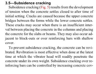

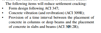

I'm on a roll today. Anyone have a good reference that I can point to discouraging the column slab pour in go because of plastic settlement cracking?
RE: Slab Column Plastic Cracks
So says ACI 224.1. And, I guess ACI 309.2. Similar recommendations in this Aussie doc: Link.

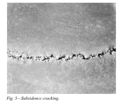

A blurb and a scary pic from 309.2
Good stuff, thanks.
"Subsidence cracking" is a new one on me, but it is the same thing as plastic settlement cracking. The blurb is correct, revibration can avoid this problem.
