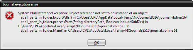

Hi Cowski,
Thanks very much for the help. I tried that out on a few designs and it worked perfectly in every case except when the part assembled in to the drawing was named similarly:
This would be the .prt assembled in to the .drw.prt.
Quote:
Export folder: C:\
1 21-22244-10000.drw.prt
C:\size 9 design\21-22244-10000.drw.prt
2 21-22244-10000.prt
open error: File already exists
Accompanied by this error:
RE: Batch Export VB Journal Questions
I figured that out, I just got rid of the extra period, and it worked fine. (1000.drw.prt->1000drw.prt)
