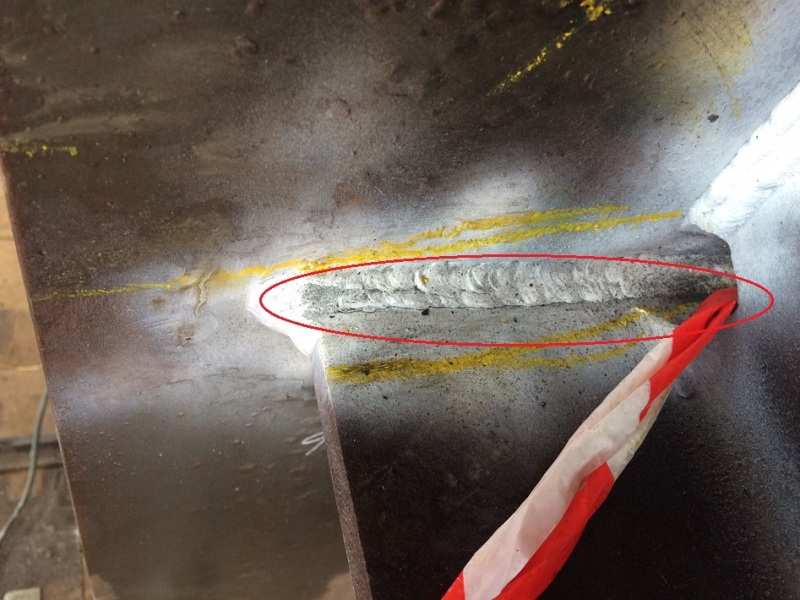

The cracks are not transverse to the weld regions but are parallel. The cracks resulted in HAZ only. The HAZ of the High CE member.
See attached pictures.

See the picture of the HAZ crack.
RE: Welding of Highly restraint joints between structral members having CE 0.47% in a process module
Thanks for the closer follow-up picture. It appears you are getting cracks along the weld toe in the high CE material, similar to underbead cracking. I don't believe this is a restraint issue, I think your preheat soak time is inadequate. Typically, cracks confined to the weld toe region are caused by lack of preheat in hardenable base material. I would increase the preheat to even 200 deg C and make sure the soak time at temperature is at least 15 minutes and not weld once you reach Tempel stick temperature. You would be surprised at how much heat is wicked away from the weld region.
Also, if you can did you run a chemical analysis of the high CE material? This material could have residual elements that pose a weldability problem.

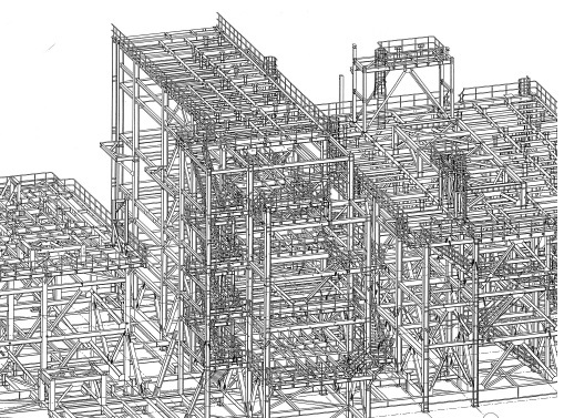

Metengr, I still have concern about the restraint acting on the joints, why because these cracks are resulting in welds attached to the columns which are of 13mtr height but no much happening on small stub column welds, equipment frames welds.

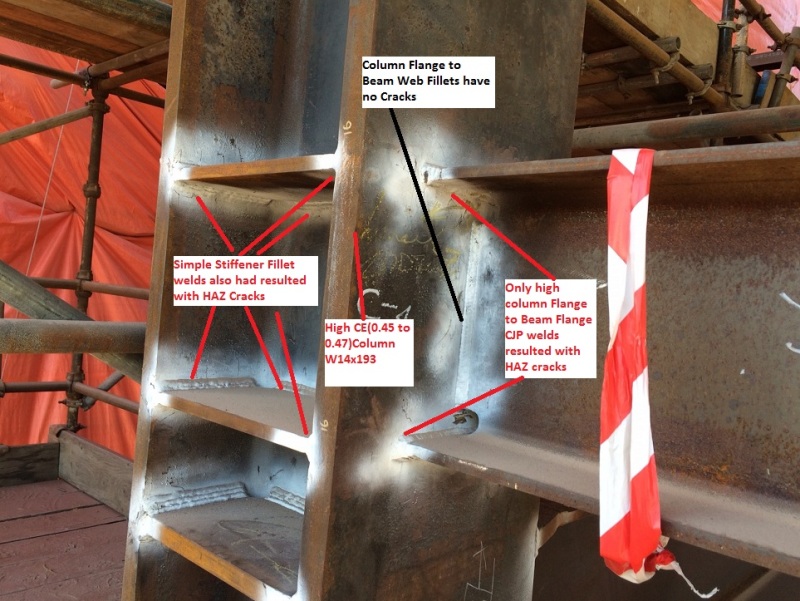

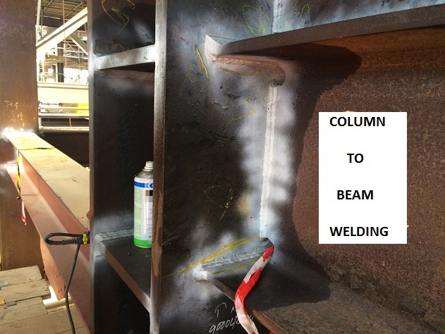

See the attached picture of kind of module this is and how many welds the column having at every elevation.
The members welded on all four sides and stiffener in the column under every weld.
These under bead cracks are happening in simple fillet welds of stiffener plates inside the columns (W14x193 where flange thk 36mm)

Appreciate your analysis on this cracks (shown in the below picture) resulted in type of weld.
Why high CE column flange to beam web Fillet welds have no HAZ /underbead cracks(is because of no restraint????)
Why simple stiffeners' fillet welds inside the high CE column have HAZ/Underbead cracks (is because of restraint???).
Had a doubt about T-fillet joint fit-up where we usually maintain gap of 0mm to max 1.6 mm gap between the members; but sometimes it goes to 2.5/3mm. ---- will it be a stress raiser adding fuel to high restraint / high hardness resulted in high CE member HAZ?
The additional picture with the locations of the cracks is helpful. Because of the consistent perpendicular orientation and location of the cracks on the column web and flanges I am thinking that you may want to try and use partial penetration groove welds in lieu of fillet welds to join the stiffener plates to the column. It may well be that the higher strength column and weld configuration is not accommodating weld shrinkage. I also considered lamellar tearing.
Try and bevel several stiffener plates on each side for partial penetration welds using the elevated preheat and heating methods we discussed above and sequencing the welds.
