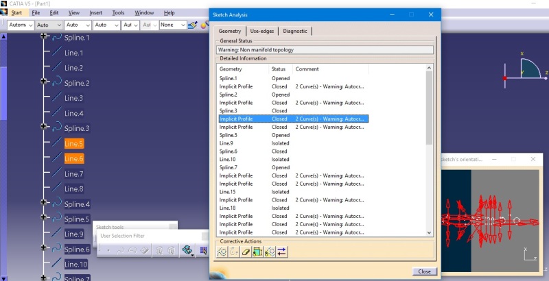

Take a look at the screen shot (CamBam font). Liked the preview option.
RE: Text in Part Design
Some fonts are just not suitable for this application. Sometimes increase of Points Per Spline could help (then it copy more precisely shape of a letter), but often font itself contains auto crossing curves and then only manual adjustment could help.
