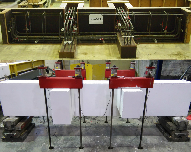

I have a sort of research to be done on strut and tie model related to reinforced concrete girder to beam joint which of monolithic cast. Here are described specimens, with a few necessary information for you to picture them. Overall test layout is simply shown below and #1, #2, and #3 are focused on showing strut and tie idealization and the only difference between specimens which is height of loading beam (BEAM). Circle is for node, black is for tension tie, red is for compression strut and dashed line is just for visual distinction of a part behind another part.
Longitudinal rebar is on the bottom of supporting beam (GIRDER) and on top of BEAM. GIRDER contains minimum stirrups with hanger reinforcement (11.2.12 of CSA A23.3-04, not required by ACI) and BEAM contains just one stirrup on each overhang, so two in a BEAM. No torsion should be induced since specimens and loads are symmetrical. Shear and bending are the only elements of external force occurring failure.

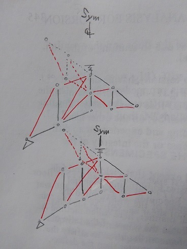

Here are my questions.
1. Should I defer inclination angle of GIRDER between specimens #1, #2 and #3, since the angle in BEAM is different? (The angle should decrease as height decreases.)
2. Is there any better idealization of specimens especially drawn parts using 3D strut-tie-model?
3. Is there any better idealization of specimens especially drawn parts other than strut-tie-model?
4. Stiffness of spring should be about 400kN/15mm according to test data, should it be modeled you think or can it be just pin for a sake of simplification?
5. What would you guess for the strongest and the weakest among 3 specimens given that inclination angle of strut in BEAM is in H>0.8H>0.6H but at the same time additional loading(11.2.12 of CSA A23.3-04) in GIRDER due to BEAM is in H>0.8H>0.6H?

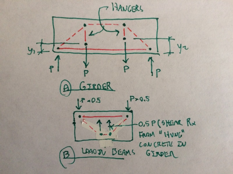

1. - The extra compression strut shown in 2 and 3 complicates and is unnecessary. The node it connects to in the girder can't be vertically resolved (needs a vertical tension tie).
2. - If you are going through the trouble of 3D then should bother with torsional modeling. Otherwise, just stick with 2D. In this case, the only interesting forces will be torsion on the beams once the rig has rotated into equilibrium.
3. - For this idealized situation, I don't think STM adds anything over plug and chug calcs (unless you consider 3D torsion). If you offset beams or have a varying cross section, then STM makes more sense. Usually, STM will give you a more conservative design.
4. - The rotation allowed by the spring is the only thing interesting. What is the purpose of this rig?
5. - I don't think the girder will play much of a role in this. At least not from the idealized situation. The way I see it, the rig will rotate and, if the spring and loads are held vertical, a twist will be placed on the beams (load is not acting through the shear center of the beams) that will be resolved at the spring support. The support at the end of the girder will be about 0.

1. Thank you for pointing out. So, the revised truss idealization should be as either one of belows. Any additional comment would help.
2. Can you add more what you see inducing torsion? As it's shown, BEAMS are symmetrical in terms both of geometry and loading about the center line drawn in the picture right above.
3. If you see any better idealization or simplification of this load transfer in this reinforced GIRDER-BEAM-joint, please give your opinion. I would be excited to hear you. For this, I add some more details of my specimens.
4. The purpose of this spring is to allow rotation/displacement of the part(sub-assembly) that I want to idealize. And the purpose of this rig (specimen or sub-assembly) is to resist vertical load with indirect support likewise girder does for spandrel beam.
5. I think you are on the same page with me as a matter of GIRDER's role. I see much less contribution of GIRDER in my idealization than it really does in real test. So, that's my problem and I'm looking for a better idealization other than FEM.
As I mentioned above, no torsion would occur by the way.

Your STM with a spring is ignoring the middle rotational restraint that the test rig will have from the girder's top and bottom chord strut and tie, respectively.
If you want simple, just use 2D for the STMs and hang your beams at the top of the girder where they intersect (the test rig has stirrups at/near the intersection - use them).
If you want complicated 3D, I'd say focus at the intersection area between beam and girder and add some elements to refine the model. You will have bending in 2 different directions here creating a saddle
The torsion I've noted will be a minor twisting due to vertical loads on a rotated beam (rotation due to deflection of the girder). I predict failure to occur on the top face of the shallower beam near the edge closer to the middle of the girder.

Which one fails first will depend on the M:V ratio of the loading beams. For low values, I'd expect the deeper beams to have more capacity. For higher values, I'd expect to get more from the shallower beams.
Like Teguci, I think that you're better off here in 2D.
